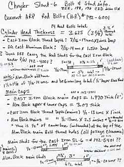

worked with ARP a few years back in order to develop a source for SL6
engine builders to get high quality bolts and studs.
Here is some general information and background on the fasteners needed for the cast iron and Aluminum Block Slant Six.
Note
that the SL6 main studs are the same as the Mopar Big Blocks, the
con. rod bolts are the same as the Pontiac 455 if I remember it
right. Bottom line is that we were able to "cross" all the
cast
iron SL6 fasteners over to other listings ARP was already stocking,
everything except the Alm. Block SL6
hardware, that stuff has to be special ordered.
I will let photos, pages and letters describe the rest. (Click on any image for a bigger view)
Go to the Alm. Block link for more photos and info on the special custom made studs for this engine. - DD
Cast Iron Slant Six - ARP Order Numbers :
Con. Rod Bolts & Nuts
142 - 6001 (full head coverage, more work ro install)
142 - 6002 (less head coverage, less work to install)
Head Studs : 142 - 4001
Main Studs : 142-5401
Con. Rod bolt kit works on all SL6 Connecting Rods
For Alm. Block Head & Main Studs, Contact ARP
( Special Order, 6-8 weeks)
