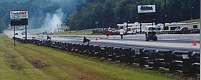

For starters, study the illustrations shown here taking
note of where all the really important stuff is at the race
track. (For a better look, click on the image.) Here's where
the really important stuff is at the race track. Places
falling into this category include:
- the entrance gate for the racers (this can
be different from the spectator's gate)
- the Tech Inspection area
- the staging lanes (which are usually
assigned to certain class cars, to line-up
together in certain lanes)
- the water box for your burnouts (if
needed)
- the starting area
- the finish line and speed trap (it's a
bigger area than you think)
- the shack where you'll pick up your time
slip
- the water tap and oil disposal drums (in
case you need them)

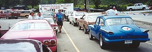

When you first come through the competitor's gate, the
track will have given you a schedule for the event. Check to
see when you can make your time-trial passes. It is also a
good idea to pit where you can hear the public address (PA)
loudspeakers. This way you can hear them "call" for the
class of cars they are running next. Many tracks have an
FM radio channel broadcasting the PA so bring a small
FM radio and a headset. Veteran racers have a good "feel"
for how much time they will have between racing rounds so
they do not get right back into the staging lanes after
making a run. Instead, they will "pit",
check or "tweak" the car, talk with other racers, watch some
of the racing action or just grab a bite to eat or a drink.
Once you pull your car back into the staging lanes you must
stay ready to jump in it and run so stay near your car. When
in the staging lanes, DO NOT lock up your car and go to the
snack bar!

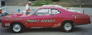

If
you give them a time (which they'll write on your windshield
/ window with shoe polish) and run faster, you'll lose by
"breaking-out", unless the guy you're racing also breaks out
and does it to a greater degree. In other words, if you
"break out" (run under) by one-tenth and the other guy
breaks out by two-tenths, you'll win because he was farther
under his dial in. You should go back and read this
paragraph a few more times to be sure you understand what's
happening here because this is the key to bracket racing.
Also note that the elapsed time you dial-in at is NOT set in
stone. If the weather changes or one lane is running faster
than the other, racers will change their dial-in time to
compensate round to round. (This is why you should have your
own shoe polish handy.) Always be sure your selected dial-in
time is written clearly and in a place where the tower and
starting line workers can see it. Your time should be
written on the passenger side of the front windshield and on
the side passenger window. (Two places minimum) It is the
RACER'S responsibility to be sure the correct dial-in time
gets entered into the computer for the run. That's right,

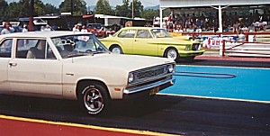

Let's regress for a minute. We are figuring it is your
first time out to the drag strip and we haven't told you
about staging and the "Starting Tree". This is how the
starting line environment works. You will be lined up behind
several other racers and will be motioned out of the staging
lanes by a track worker when it's your turn to run. Pay
close attention to these track workers and follow their hand
signals. (Basic pull forward, stop, or go to that lane hand
signals.) At smaller events, you might have to wing it.
Whatever you do, don't do anything rash at this point or
you'll risk being tossed out of the track. The drag strip
will have a burnout area about 40 or 50 feet behind the
starting line. The
area usually has a shallow concrete trough with a little
water in it and if you're running drag slicks, the idea is
to position your car so the rear wheels are in the trough.
Whatever you do, don't start your burnout until the starting
line person or a track worker motions you to do so. They
will want you to wait until the cars in front of you leave
the starting line and have cleared the area. A burnout is
NOT a good idea for most street tires because they give
better traction cold, so if you are a beginner bracket
racer, running on street tires, don't complicate your
starting line procedure with a big smoky burn-out. You would
be best advised to drive AROUND the water and get the car
positioned in the center of your assigned lane,
with the wheels pointed straight. If you leave enough room,
you may want to do a quick "throttle punch" just to get a
feel for the starting line's traction. If you get immediate
wheel spin you will know to take it easy at the start of the
race. Watch some of the other racer's technique for pointers
on the staging process, but remember, just because all those
fancy race cars with slicks do burn-outs, it does not mean
that you have to do one too.

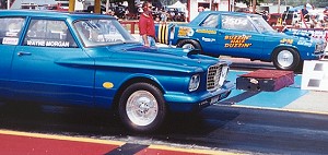

Take a minute before you make your first pass to look at
the Christmas Tree. At the top, you will see a vertical pair
of amber bulbs marked "Pre-stage" and "Stage". They are
either illuminated or dark, depending
on whether or not a pair of photocells across the starting
line (at near ground level) can "see" a pair of spotlights
on the opposite side of the lane. (By the way, on the
starting line, the cells are in the middle of the track and
the lights are outboard, it's exactly opposite at the finish
line. Light bulbs are cheaper than photocells and if you
drive over anything at the finish line, the track wants it
to be lights instead of photocells.) Pulling up to the
starting line, your front tires will first break the
"pre-stage" beam, illuminating the top bulb. Roll exactly
eight inches
farther, and your tires will break the "stage" beam,
illuminating the second stage bulb. In NHRA competition, you
must have both staging bulbs illuminated before the starter
will begin the starting light sequence. "Deep staging," by
continuing to roll forward would turn off the "pre-stage"
bulb, leaving only the stage bulb lit, in effect, moving the
car closer to the actual starting (and finish) line. Some
events allow you to do this if you write "DEEP" on your
window. Doing this can help improve the reaction times of
slow reacting cars. Whatever technique you use, it is
important to stage your car in EXACTLY THE SAME PLACE every
time you come to the starting line. The best bet is to move
the car up into the staging
beams SLOWLY and stop right when the second "stage" light
comes on. Below the pre-stage and stage lights are three to
five amber flood lamps, then a green one and a red one, in
descending order. Typically, (although by no means always)
the amber and green bulbs will be lit at 0.5 second
intervals to start the race. Sometimes the interval is 0.4
seconds. If you're in doubt, ask the starter what the
interval is going to be. In e.t. bracket racing, the car
"dialing-in" the slower time will be allowed to go first by
the interval time difference between the respective
dial-ins. Theoretically this "handicap" start will allow for
a perfectly matched race at the finish line. It's a
good
idea to look over at your opponent's car to see what his
dial-in is so you'll know if you're going to sit for a
second or two, or if you'll be expected to leave first.
Sometimes, a small amber signal light, placed between the
larger amber floodlights, will be lit to show the driver in
the faster car, (in whose lane the small light is shining),
who should stay put while the slower car gets the green
light first. Most of the time an SL6 car will be slower so
it will get the green first.

When the race car and the track "starter" look like this,
you need to be focusing all your attention on those
Christmas Tree lights!
