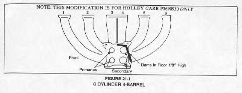

The original Hyper-Pak four barrel manifold is probably the best bet for intake manifolds. Refer to Chapter 21 for jetting information.
