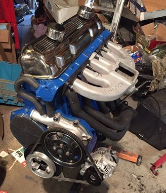

Ok, I name all my engines. I am not sure when or why I started this, but here is the engine, Dragon, that is going in the 65 Belvedere. I got tired of waiting on the head, so I put a spare one on the racing short block. I wanted to mount the alternator, verify pulley alignment. I also wanted to see how the intake and headers fit.
With any luck, I'll have the race head back and the engine in the car by the end of the month.

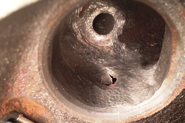

Trying to rush things and wouldn't you know it, I cut into the water jacket while finishing up the head porting. This after waiting three months to get the frikkin head from the machine shop. I have ported dozens of big block heads with no problems. I just wasn't careful and I was in a rush.
Dag Nabbit!!!
At this rate, I'll see you guys next year, or the next....
sigh...
I'm off to find another head.

PostPosted: Wed Sep 14, 2016 6:22 pm
Posts: 761
Location: St. Louis Park, MN
I have had the same thing happen on two different heads. I had them repaired by a guy who specializes in welding cast iron then coated the inside of the head with some sort of ceramic coating and the repair hasn't failed yet. Afterwards you do have to touch up the deck surface and the valve job to correct any warpage.
PostPosted: Wed Sep 14, 2016 7:15 pm
Posts: 1434
Yes, I'd love to get the head repaired. I have been looking for someone local to repair it but I haven't found anyone I trust won't make it even worse.
In the meantime, I'll find another head and start over. I'm not ready to give up on the slant. The harder things get, the more determined I am.
