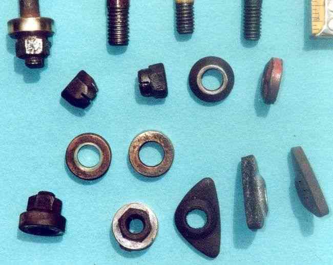

Manifold set to Cylinder Head Studs are 5/16-18 unc x 1/2" thread length (head side) by 5/16-24 unf x 3/4" manifold side.
The factory stud was 1 7/8" in total length so there was about 5/8 inch of unthreaded area between the two threaded ends.
Many of today's replacement "aftermarket" studs are either a little long (2 inch total) or a little short. (1 3/4" total) The thickness of the "spanner washers" to be used, will help decide on which stud to get.
