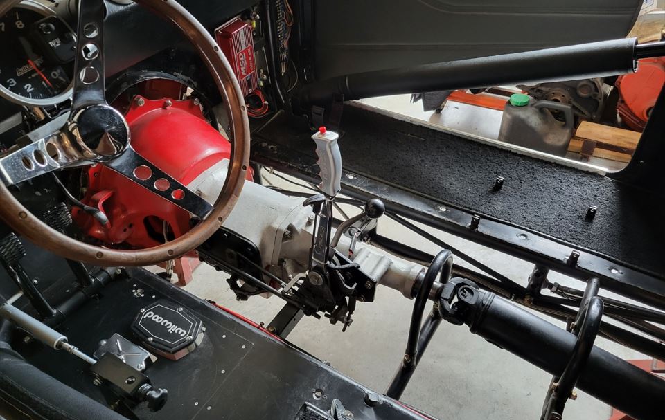

Posts: 1696
Only an idiot would pay what that dang thing cost.
Pretty don't make it fast.
Going to see soon.
