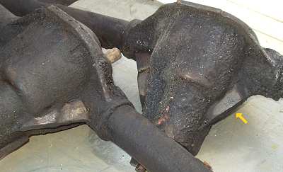

Anyway, the rearend your friend has is most likly a 7 1/4, like the one already in your car. most 7 1/4 have the gear ratio stamped on the housing so have him scrape off the grease to find the ratio.
http://www.dutra.org/pictures/parts/7.25-2id.jpg
http://www.dutra.org/pictures/parts/7.25-id-cl.jpg
