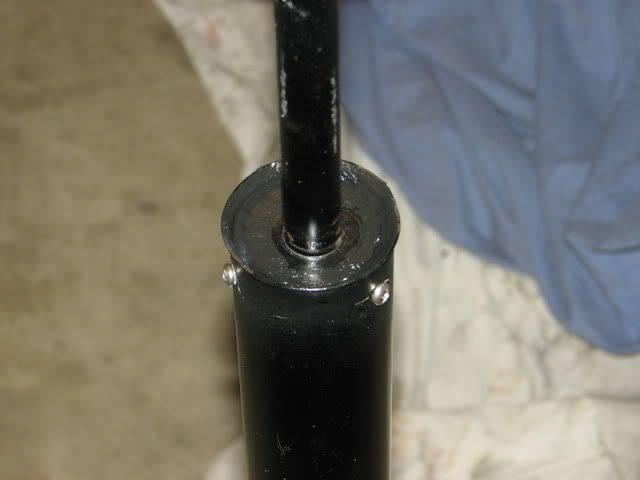

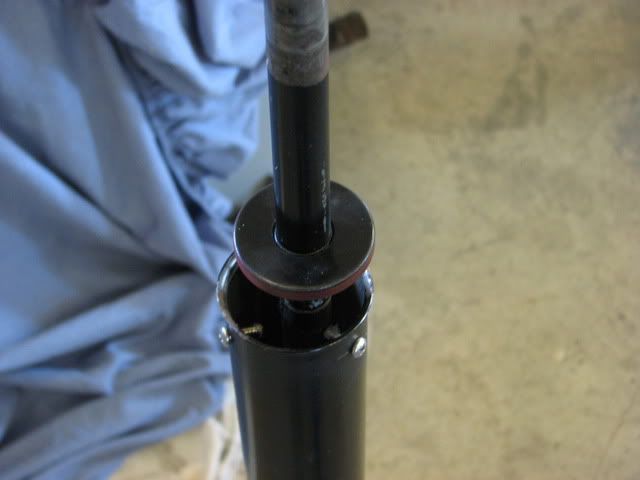

I found the special lower seal, but they were $40-60. So I just went to the Timken seal catalog and got one that fit the shaft ( .750) and just fit inside the lower column tube which is 2". The seal doesn't drive in the tube snug so I just set 3 small sheet metal screws in tube and slid the seal up inside about 1/2". Then I ran a bead of silicone around to seal it up. I will let you know how it works out,
Rick
PS I will post the seal number I used later if someone wants it. I paid $12 for it but found it on line for $4.99.

The seal number is a National / Timken # 473407, and it had an OD. of 1.987 so it fit nicely inside the tube. If someone was really good with the caliper and wanted to take a chance they could probably find a seal that could be driven into the tube. I knew I would never be so lucky to have it work so I took the safe route and got one just slightly small.
Rick
