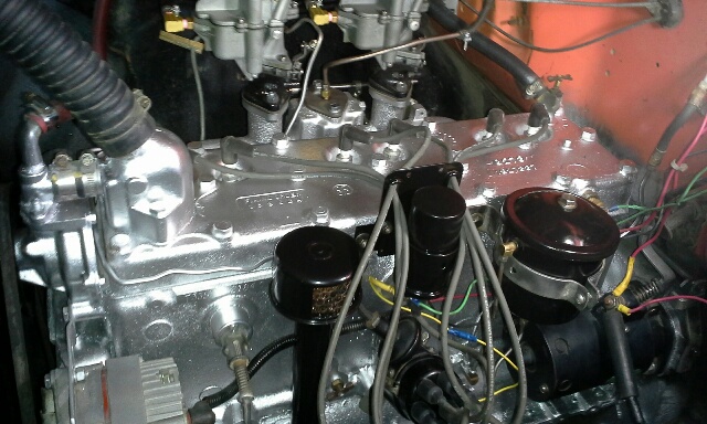

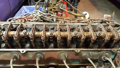

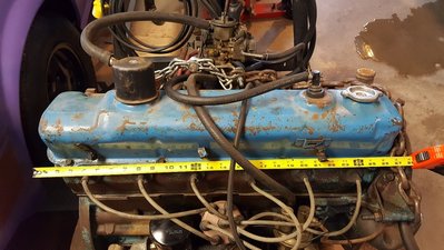

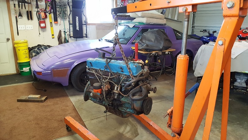

PostPosted: Fri Feb 16, 2018 7:15 pm
Posts: 107
Car Model: 1955 Dodge Truck
Some pics the 225, and the rockers and oil pan

The 55 Fargo and the IND 265 Flattie
