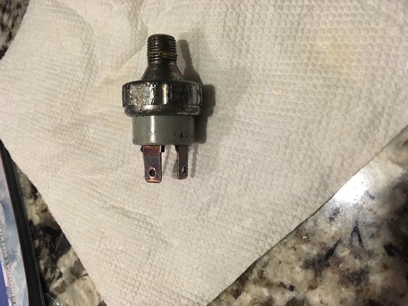

Ever had an three pin oil pressure sender fail and allow all the crankcase oil to blow out?
About 30 miles SE of Indy, cruseing back home on I74, notice a haze behind me in the rear view mirror,
saw low oil pressure on the dash gauge then the motor shut off. I was going at a good clip, shifted to neutral
and was able to coast up the next exit, make a slow right turn and coast into an Indiana town named appropriately, Pleasantville.
Cranked the motor, nothing, got out an popped the hood, noticed a lot of oil on the side of the block around the oil pump,
pulled the dip stick, the crank case was empty.
About that instant a local in a jeep, later I found out his name was Justin, stopped, complimented the 83 D150 and asked if I needed help.
Yes, I said I could use some motor oil, he said he had just bought a gallon, lived close and would be right back. In moments he returned with
a 5 qt gallon of full synthetic motor oil, I gave him 20 bucks for that.
Put the oil in, the motor started, I went under the truck to see a steady stream of oil shooting from the 3 prong oil pressure sensor. I have an electric
in tank fuel pump and that sensor is the trigger for the relay that sends power to the electric fuel pump.
I got under the truck removed the 3 prong sensor. I could run the truck with out the sensor as I have a swith installed to bypass the oil pressure sensor
for starts after the truck has been sitting for a while.
I needed a 1/4 pipe plug, I did not have one of those loose, but I do carry a fuel pressure gauge and it screws into a test port on the fuel system that has a 1/4 pipe plug.
Installed the test gauge into the fuel pressure test port, installed the 1/4 inch pipe plug where the oil pressure sensor was, and with the oil in the crankcase
that Justin delivered, got back home..
Justin stayed there the complete time, turned on the overhead light bar on his Jeep, light up the whole area.
He has an 89 D150 with a 360 that he is reworking.
crazy but true. Out of the blue I got the help I needed and I figured out that I had the part that I needed.

Not on a slant, that I can recall. I have seen many OP switch failures, but not that drastic. Usually just a drip type leak.

I have driven the 83 D150 for several days since the oil pressure sensor failure.
Oil pressure via the dash gauge is 100% normal, no unusual noises,,,
It seems that as the oil pressure went away the fuel pump powered down and
the motor shut off.
With the exception of the sensor failing catastrophically, everything worked as it should.
I put in a NAPA Echlin sensor, hopefully it is more durable than the Standard Motor Products
sensor that failed.
