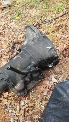

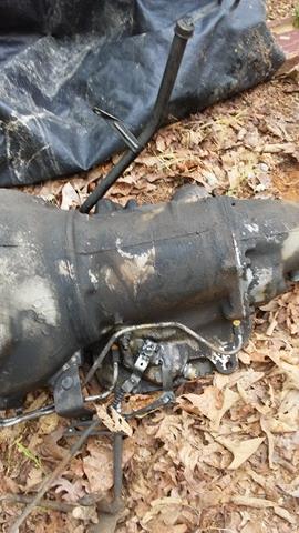

Supposed to have been pulled from an '81 pick up. Does it being a truck transmission make it a difficult swap into an A body? Do I need to keep looking for an A body 904?
PostPosted: Thu Apr 25, 2019 10:50 am
Posts: 17689
Yes, looks like a Slant 6 904. Should be a direct swap to any A-body. Assume you know about large/small crank hub/pilot hole and converter match up...
PostPosted: Thu Apr 25, 2019 10:53 am
Yes I am aware of the input shaft sizes and such. That is one reason for the swap. So does it matter that it came from a truck? Still a direct swap?

The 81 904 will likely have more clutches than a car slant, a wide-ratio gearset, and it will be lockup. None of these are really a bad thing unless you are racing and don't like the larger RPM drop between 1st and second gears.

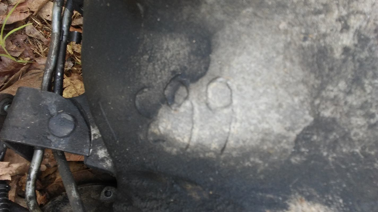

The numbers are:
4058383
http://mymopar.com/downloads/transguide.pdf

According to Tom Hand's Torqueflite book, 4058383 is 1981 Dodge truck, 225, 904, wide ratio gear set, lock up converter.
