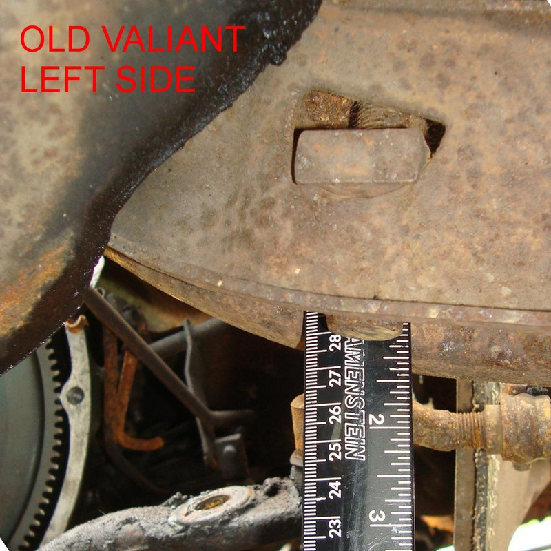

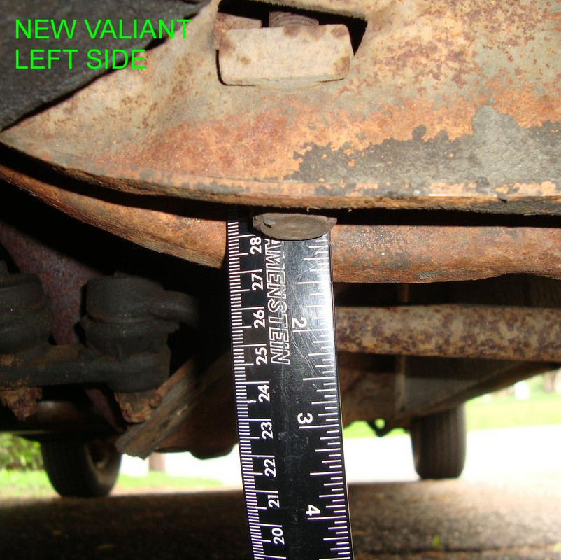

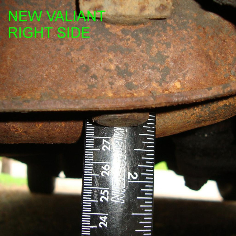

Checked the front ride height as per FSM procedure. Difference between lower ball joint and adjusting blade should be 2 1/8" if stock. It's currently only around 3/4" difference on both sides!! YEAH. Like I said... LOW.
Here's the thing that throws me for a loop. The adjustment bolt appears to be in its normal "average" position. It doesn't appear that the car was lowered via the adjustment bolt. Which leads to my actual question here:
Is it possible that previous owner lowered the front end by relieving torsion bar tension by positioning the torsion bar off by a "degree" (not sure how else to phrase this). Is that a thing? Do people do that? Would it explain the low ride height but apparent lack of adjustment via adjustment bolt? Or is there something I'm missing here?

Not really. It all works together when you align the rear hex to the lower control arm hex. All with pressure off. Then when you load it, it twists due to load. Does it look like some work has been done to the suspension? Have you looked at the t-bar crossmember? Maybe some rust repair was done. If all looks ok, I would put a socket on the adjuster and give it some turns to see if it will come up.

It's just odd to me that my previous Valiant and the new Valiant both have their adjusting bolts in roughly the exact same position, but the previous Valiant is at correct 2 1/8" ride height while the new Valiant is at 3/4".
I could be wrong but it seems like I'm going to have to seriously drive that bolt in a significant distance to get to the proper ride height. I suppose I can give it a try.

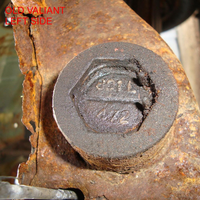

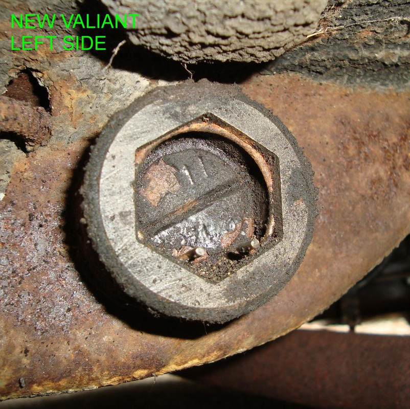

If you remove the rear retaining clip you should be able to read the ID numbers and find out what size they are and whether they are on the correct sides.

Here's some pics. The torsion bar stamping pics are pretty muddy but it looks like both cars have 891L and 890R installed on correct sides. The adjustment bolts on NEW Valiant aren't threaded quite as deep as the ones on OLD Valiant but they're in approximately similar positions (sticking out about 1" or slightly over). If NEW Valiant is riding so low I fear that adjusting bolt will have to be pushed in significantly to get the ride height where its supposed to be. I'm still having trouble not thinking that something is wrong with how the torsion bars are installed on NEW Valiant...
