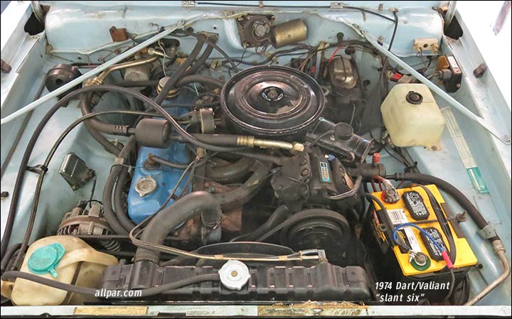

“You can do it quickly and cheaply by running two 10ga wires with ring terminals at each end directly from the alternator's output terminal to the battery + terminal. Each of these 10ga wires must have two 50A fuses, one located within inches of the alternator output terminal and the other located within inches of the battery + terminal.”
Okay, this makes sense. Questions now... I’m finally ready to do this thing...
1) Ring terminals and fuses — any suggestions for specific parts (e.g. fuse holders)? I'm at a loss. For the fuse, are we talking about something like this?, with one lead at a ring terminal and the other connected to the 10 gauge cable? https://amzn.to/2LwEDVV or illustration
File comment: Fuse
2) Any pics from someone who has done this?
3) Just confirming, the alternator terminal is the one that's marked "output" in this image...
4) How do you feel about this advice from Dan’s favorite maven [cough], Rick Ehrenberg? https://www.allpar.com/history/mopar/electrical.html #5 — “Connect a fusible link to the starter relay stud. Crimp-splice in a piece of suitable (heavy-gauge) wire, and connect the other end to the alternator stud. That’s it....firewall problems bypassed forever!” (I assume it's one end to the output stud above, and one end to the positive end of the starter relay. Guess the ignition switch still works by interrupting the ground?)
Is the Ehrenberg thing basically doing the same as Dan’s, only instead of going to the battery, you go to the starter and rely on the big heavy battery-to-starter cable for the rest of the way?
Yep.
Yep.
For very little extra money and effort you can do a whole-assed job of it.

My one big question then is how I connect to the battery terminal... what kind of fastener?
PostPosted: Sun Sep 15, 2019 5:58 pm
Posts: 25021
Ring terminal/nut.

I can't figure out how the ring terminal/nut would attach to the battery terminal. The battery-to-starter cable doesn't have any attachment points at the battery. I can see why Rick E. thought it made sense to run from the alternator output to the starter — it avoids the problem of hooking up to the battery, and the wire is less noticeable (for those who raise their hood during shows).
PostPosted: Sat Sep 28, 2019 10:14 am
Posts: 25021
Er…what's not to figure out? Look at your battery cables where they attach to the battery itself. See how they clamp onto the battery with a bolt and a nut? You remove the nut, put the ring terminal on the bolt, and replace the nut thus holding the ring terminal to the battery terminal.
PostPosted: Sat Sep 28, 2019 11:41 am
Joined: Tue Sep 10, 2019 8:16 am
Posts: 8
Car Model: Valiant
A photo would be worth 300 words, I suspect... oh, wait, I get it, I think. We attach to the nut and bolt that are used to tighten or loosen the battery cable "end clamp" ?
PostPosted: Sat Sep 28, 2019 12:26 pm
Posts: 25021
Yes.
