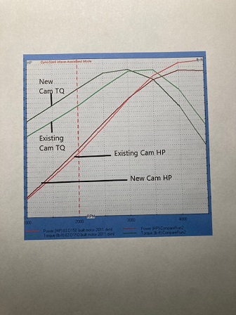

I had pulled the motor to address a clutch issue, but since it was out,,,
I am going to install the NOS Mopar Purple Shaft P4529340 Hydraulic cam that I had picked up at the ICH swap meet a few years ago.
The current cam is a 256 / 250 advertized duration the cam to be installed is a 240 / 240 advertized duration so I know that I am going smaller.
The smaller cam gives up some HP and TQ at higher RPM levels, but since I have the 68 Barracuda available, I don't plan to have the 83 D150 racing on a track.
The additional torque off idle and up to highway speeds looks promising to me.
I have the motor down and cleaned up, the plan is to do the cam swap tomorrow.

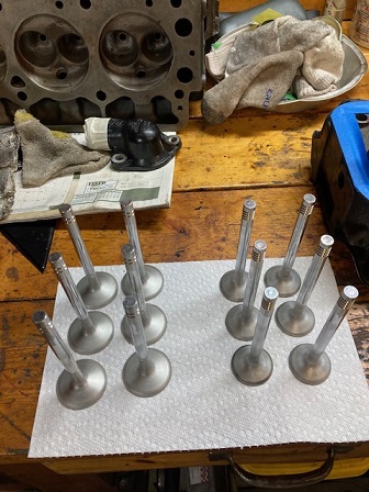

The big project today was cleaning up the intake and exhaust valves. I should have got a before photo, the intake valves had a lot of coking on the back side. I had positive valve seals on the intakes, but it appears that those seals were leaking. I had umbrellas on the exhaust valves and they had some carbon on them but were fairly clean.
I soaked the valves in Berryman carb cleaner over night to soften the carbon build up, then the valves made a quick trip through the blast cabinet.
After that I ran the valves for a bout an hour in the vibratory mill with the abrasive hard plastic pyramid media.
Then ran the valves in the vibratory mill with crushed walnut shells for about 4 hours to polish them.
they look like new
 Post subject: Re: 83 D-150 Project
PostPosted: Mon Apr 19, 2021 11:39 am
Posts: 10238
Looks Good.
I just wire wheeled my Junkyard 318 Valves on the LA engine I did over the winter, Then Lapped them on seats before installing.
You are much more thorough!
