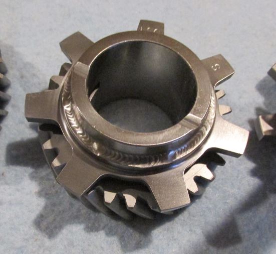

Here are a couple of images of the work.
I had my main case steel bushed for the countershaft support.
It's an all aluminum cased transmission.
2nd, 3rd and 4th are faceplated.
I have a syncro for 1st.
