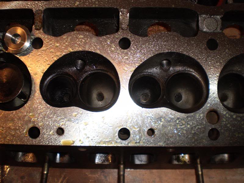

One head is in the US.
Here is the chamber shape.

PostPosted: Thu Aug 27, 2020 7:15 pm
Posts: 3853
when I look at that combustion chamber, I see a lot of valve shrouding
on a cylinder that is already constrained for valve size.

Posts: 14766
Last I knew the Argentinian head was in Minnesota. Current owner supposedly had it flowed and was underwhelmed at the numbers.
I have seen another head with welded up chambers like that. Last I knew it was on a Slant 6 record holding car.
