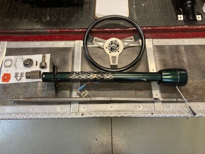

Previously rebuilt the steering column and the steering box in the 68 Barracuda.
The column has all new bearings, and the box has new internal components with a 16:1 ratio.
The steering wheel is a Mopar Tuff Wheel, it is a little smaller diameter than the stock 68 Baracuda steering wheel
Daily driving, it is fine turning the steering wheel, if the car is moving just a bit the steering effort is not overwhelming.
However, I ran the 68 Barracuda in two SCCA Autocross events, and in both, they had a slow speed chicane set up, where there were a series of three cones set up in a straight line, maybe 30 feet apart.
One really needed to turn lock to lock quickly to stay close to the cones. I could not get the car around quick enough on these slower sections. So I am adding electric power steering.
Worked today removing the steering column to get ready for the install.
I have purchased the EPAS power steering unit. Delivery is scheduled for this weekend.
https://epasperformance.com/
I understand that folks hack salvage yard electric power steering units but I was looking for one that was a fully developed package with a warranty and tech support.
The EPAS package is complete from the steering box coupler to the fire wall bearing to the electric power unit.
I will post again as the install moves along.
