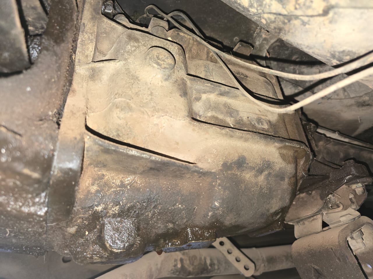

I really don't think it's the A833 I'll take pictures of it when I change out the throw out bearing. Because when I replaced the clutch I was told it wasn't a dodge but a ford clutch.

Here are the bottom pictures If you can id the transmission.
PostPosted: Wed Sep 11, 2024 6:39 am
Posts: 8987
For sure not a 833 OD. That is a "top loader".

I've been having issues trying to id the transmission. All I know is that it's a ford since it has a ford clutch in it.
