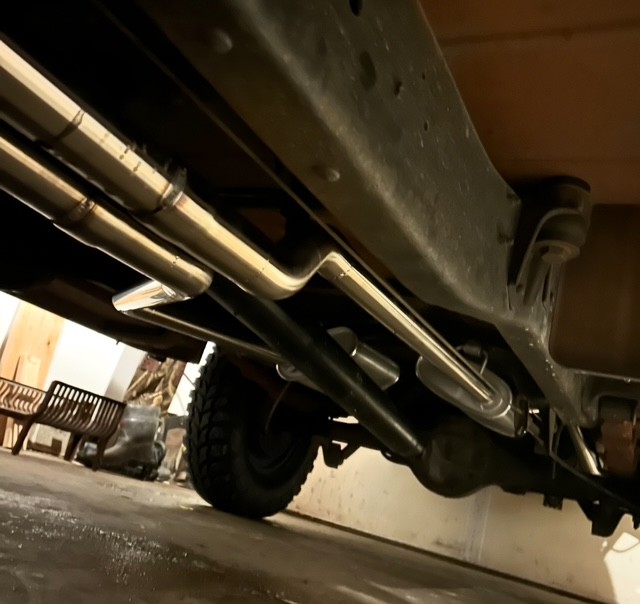

File comment: I'll look into it. Would my exhaust configuration/reduction of backpressure have anything to do with it?

I will heartily disagree with Dan on the intake issue. That 2bbl Aussiespeed long runner is superb at low-mid range. It should be perfect on your truck if the carb is jetted right. Better than a 1bbl or BBD on a stock 2bbl intake. Yes, I have personal experience with that setup. I did not have fuel puddling or bad behavior at low temperatures, at least down to about 30 F. I did run the 500 2bbl, which works well on about any Slant (yes, I have run it on stockers and 11:1 race motors), but the 350 should be as good or better given the mild nature of your engine. That intake actually does NOT work well at high RPM and really shines from idle to about 4500 or 5000.
It would really help you to have higher compression and more head flow for your application, but it sounds like that will have to wait. I second Greg's comment about going to a 3.91 rear gear with those tall tires.
Lou - I never rejetted the carburetor or messed with the accelerator pump setting...i'm thinking it may just be running lean since it's bogging down. My Holley 2300 350 CFM is straight out of the box. Thoughts?
PostPosted: Thu Feb 13, 2025 12:27 pm
Posts: 17641
The 350 should not be that far off out of the box. Make sure the valves are lashed properly and you map your timing curve, especially since it's an aftermarket distributor. Or for a coarse test, just try advancing it 10 deg and see if it runs better. If worse, retard it 10 deg from where you started. My wild guess is the timing needs to be advanced, but hard to say. You made a ton of changes in one go.

Lou - truck is running great now. Turns out my bogging issue was a heavily corroded fuel tank which i've since replaced. It's still sluggish in 1st so i plan on swapping toa 3.91 rear gear. Seems like parts are widely available! I'll report back on what i find out. I haven't done anything with the head or cam. Might mill the head and do a 3-way valve job.
