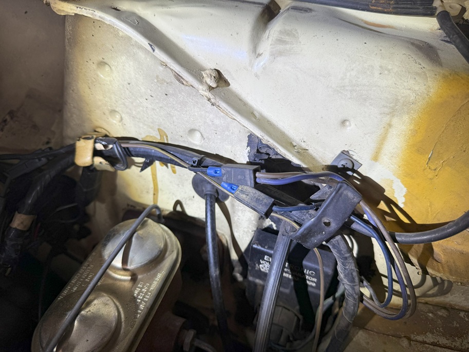

I did not install the Pertronix system myself, so I looked around a little more. I found where the ballast resistor had been removed, and the connectors had been jumped together. Looks like a fine method to me.
File comment: Ballast Resistor Jumper

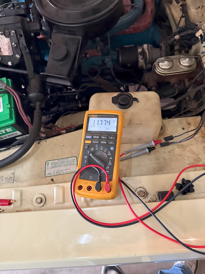

Checking voltage with my multimeter from connector to connector of those wires showed 11.77 volts. So seems like I'm dropping quite a bit of voltage from this connector to the coil.
File comment: Ballast connector voltage

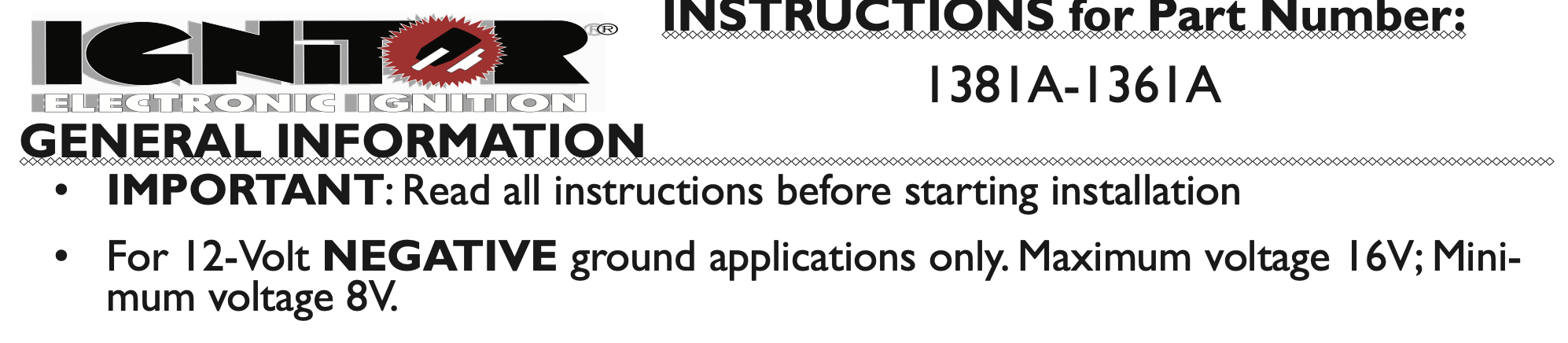

Um, not according to their instillation instructions.

I just looked at the package I bought (P-I) for a backup dist I just built a few months ago. It says minimum 3.0 Ohms for 1 to 6 cylinder engines, and to run a ballast if your coil primary has less than 3.0 Ohms. It also says maximum of 4.0 Ohms.
It does also say that leaving the ign on for extended periods can burn out the Pertronix unit. Same with points (if they happen to end up closed).

Unplug all 3 Engine compartment firewall connectors and clean then re plug your terminals to the firewall bulkhead. This is common on old A bodes and can show up randomly as other things will not work correctly and or "Fail"

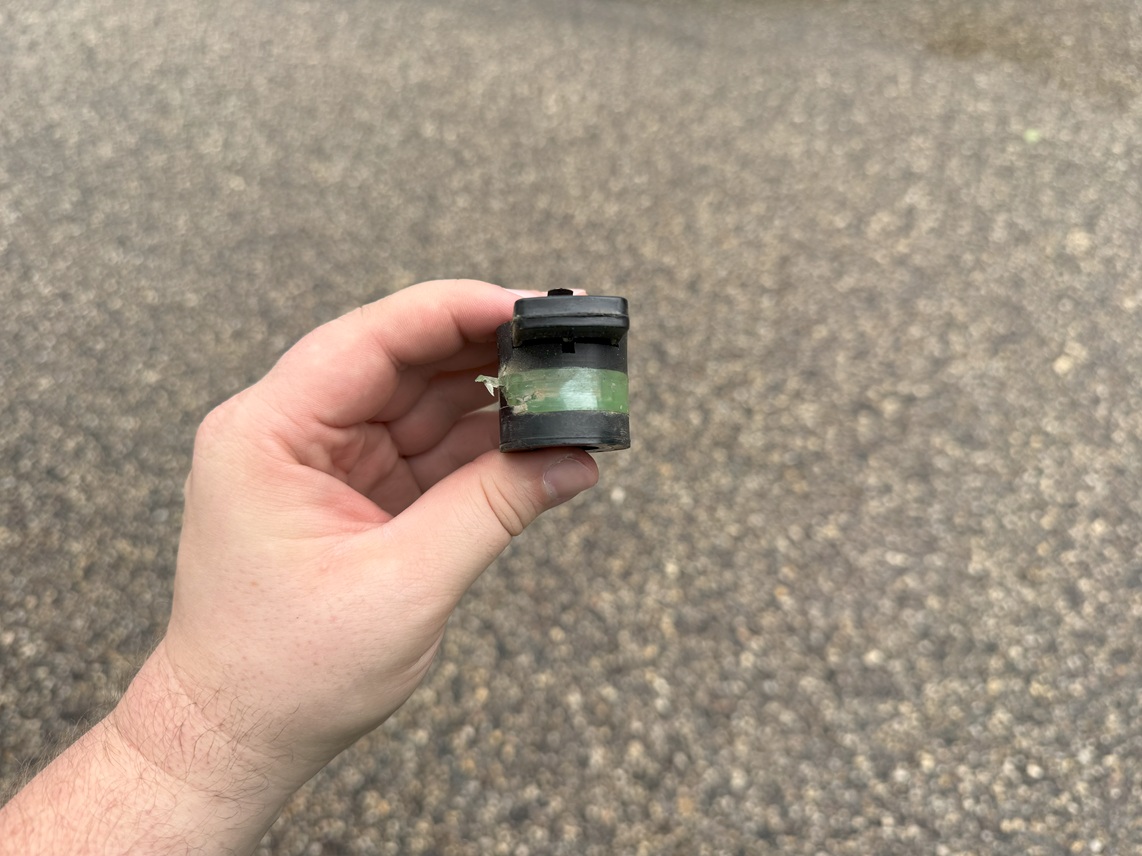

I got a good start on the project today, and removed the old Pertronix kit. I may have messed up when I ordered that kit, now I'm fairly confident that it was the Ignitor I system with a 1.5 Ohm coil. I also found the distributor rotor had some damage. Not quite sure how that all happened, but since I'm the one installing it this time, I'm hoping to take a bit more care on it.
