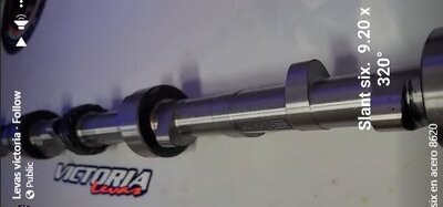

I found a lawn mower cam that looks interesting.
What do you think Slantzilla?
Author:  slantzilla [ Sun May 26, 2024 11:22 am ]
Looks like the next thing you could confuse yourself with. :mrgreen:
