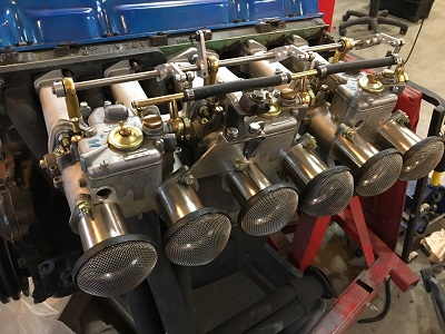

After talking to some hardcore racers I decided that it was worth a try to go to a little bigger carburetor. I know all the calculators say not, but real world ET's trump calculators in my book every time. I figured I would stay with what I know and get a 750 edelbrock and try that. Indeed I came to find out this week that my boys were going to go together and get me a new Carburetor for Christmas. That was very nice! But as nice as that was, I won't be needing it. That is because this is setting in my garage on my back up motor! :D :D New Webers!!
After Ryan and I get his new engine running in Seymour's old car, I will start the install on the webers! Guess I will have to learn how to tune something new after all!
Rick

I'll need to see what setup Seymour/Ryan's car has. That should put me in the ballpark for tuning! Yes I will be excited to see it run! I always loved the way they looked and have always heard that they were the best carbureted setup available! :D :D

The only thing I can tell you about Webers is they do not like fuel pressure. They need 2 to 3 psi. Any more and you will be forever chasing a pig rich condition.

Gathering info on a fuel system for the Webers. Right now I am running a stock fuel pump with downstream filter. I will probably go ahead and switch to an electric fuel pump setup and would appreciate any insight you may have. It looks like some people are running the Carter rotary vane pumps P4070 for higher volume lower pressures. They are still 4-6# so I would need to install a pressure regulator to cut the pressure to 2.5-3#.
1) Are any of you familiar with this pump and is it a decent pump?
2) If I mount the pump at the rear should it have a filter before the pump? Or after?
3) Would the larger canister type filter be better than the smaller in line filters.
4) Any type pressure regulator better than another?
Thanks for the help!

I had one of those pumps on a 74 Roadrunner with a 383. I like to run a filter before any electric pump just to keep the pump clean. Should always run an electric pump at the back as they push fuel way better than they draw fuel.

Any filter before a pump should be either the sock type or one for a gravity fed carb.
Otherwise you may not get enough fuel flow (or none).

I know of numerous cars running a large (Fram) canister fuel filter between the tank and their electric fuel pump. I put one on a 69 Charger. Big block car and definitely not starved for fuel.
