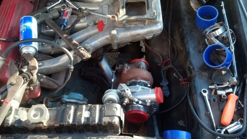

got it all wrapped up today for the most part. all the lines are ran pump is in and pumping. runs, doesn't flood but the fuel pressure gauge isnt reading any pressure. haven't messed with the regulator and not sure if its rising with boost yet. ill figure it out in time. i pulled the tank today went pretty easy. used the pump to get the gas out. the filler neck gasket/grommet disintegrated when i pulled the filler tube out. new one is on the way so i have to wait for that to make a test run. so far im happy with it. time will tell.
<img src="http://i125.photobucket.com/albums/p79/weesers1/IMG_20140818_120031_465_zps6a4c034c.jpg" border="0" alt=" photo IMG_20140818_120031_465_zps6a4c034c.jpg"/>
really wanted to get the return bulkhead fitting higher up in the tank but the hole from the sending unit wasn't big enough to fit my fat fingers any farther than i made it. this could prove to be problematic in the future so ill have to keep an eye on my fuel level. put the new sender in. didn't notice if it worked or not yet was more concerned about getting it running again.

I see in your last pic here, you have the wideband right in the back of the turbo on the downpipe, does it function well there? I always saw things suggesting it be 18 inches back, but I personally wanted it near where you have it. Does it even matter? Or just as long as it's after the turbo?
PostPosted: Thu Aug 21, 2014 10:17 pm
Joined: Fri Apr 27, 2007 5:50 pm
Posts: 745
i heard the 18" from the outlet. i consider that to be the end of the manifold. then i have the j-pipe and the turbo so i figured i would be safe where it is. seems to read well. figured the extra heat might keep it from fouling the sensor. i dont know if it matters. if it stops working for any reason ill be sure to throw an update in here. fwiw i think it is reading accurately. i can smell when it is running rich when stopped and low speeds and the gauge verifies what im smelling.
