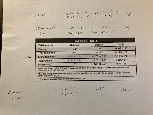

I think you ment camber where you wrote caster, but understood. The current alignment was not intended to be the end. Perhaps to cut to the chase, to get to negative camber that will result in some reduction in positive caster, which is limited due to the OE upper control arms, all things staying as they are, do you believe that would be a good swap, trading away some positive caster for some negative camber?

I meant exactly what I wrote. Positive caster increases both stability and steering effort. Positive camber reduces cornering grip.
Here are the 1965 AMA specifications for the Valiant showing the small amount of positive caster on manual steering cars and the small amount of positive camber for all.

Josh, I agree that the alignment specs for a 65 Valient that you linked are exactly like the stock 68 Barracuda specifications that I had listed in this alignment posting.
Also, I have not welded in place any of the adjustments. I like to start someplace repeatable, right now for caster and camber it is with the adjusters clocked in their max position.
I plan to drive the car, do test runs then make adjustments to feel the results. That is why I went through the process of developing my own tooling-process for garage alignments.
I will be doing the alignment thing again.
The chart below lists several alignment settings for Mopar torsion bar cars. Where I am starting aligns to Max Street Performance. Again, there is no guarantee the alignment that is on the car is optimized or that is will it will stay. Its all part of the process.

I have set my cars up quite close to those Max Street Perf specs since about 1998. Works well. Project V is a bit more aggressive with the caster (+5 or +6) and camber (-1 to -1.5).
PostPosted: Fri Nov 06, 2020 8:01 am
That Max Street Performance line should read -.75 to -1.0° camber. Never, ever do you want positive camber when seeking grip.

PostPosted: Sat Nov 07, 2020 8:48 am
John,
I missed that you posted the original alignment specifications. I see how my posting of the early alignment specifications seemed like a lecture. This is a long thread covering many subject areas and I didn't get all of it. My mistake.
The photo of various performance alignment settings has an clear (to me) error. Your posts suggested to me that you hadn't perceived the error in that chart and thought that you were in that alignment range. You're not. There are serious ramifications to having the camber that much positive. I kept trying to make that point and it wasn't well received.
It's likely that your car, with the present alignment will drive pleasantly enough. But when pushed your car will not follow the intended direction of travel and will leave the road nose first with the front tires at a severe angle to the car's actual direction of travel. This is severe understeer.
Being able to align to the numbers is all fine and good, but knowing what these various alignment settings will do to the behavior of the car is arguably more important. Fred Puhn can help and at this point in time for only $8. https://www.thriftbooks.com/w/how-to-ma ... 0912656468

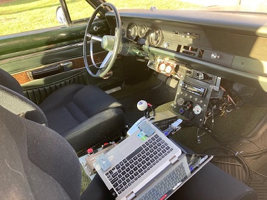

Videos of the:
* alternator and ac compressor belt alignment
* dash view showing air air temp, note voltage with ac engaged, blower on high, electric fuel pump running, MSD box firing, condenser fan on,,,
* MS3 screen shot engine vitals with the ac running
https://www.youtube.com/watch?v=zOjmu97 ... e=youtu.be

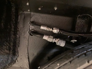

Photos of the
File comment: AC lines ran in fender well

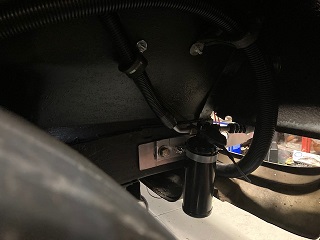

File comment: AC dryer in fender well

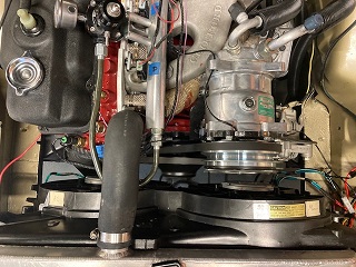

File comment: passenger side fan is activated by the AC and engine temperature sensor, driver side fan is activated via a dash switch

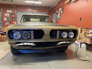

a little more progress on the 68B, installed a front spoiler. If this CV 19 hangs on I am going to run out of things to do. A few more loose ends to tie up and this car can sit in the garage over the winter, ready for 2021.
