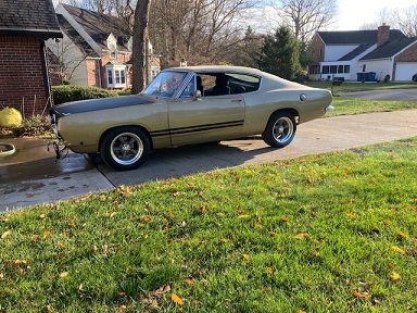

Drove the 68B out of the garage last Monday and around the neighborhood. I don't have plates on the car so I don't want to go to far. Also wanting to test things out for reliability.
In the neighborhood streets I stayed below 25 mph,, with the alignment the car felt great, previously even at 25 mph or below the car just did not feel stable, as it was not aligned at all.
It does have a 'place to start' alignment and it feels great. The steering effort is much reduced from what it was,,I believe it will be fine,,Once you are rolling it is just point and go.
There is a lot of tuning to do on the motor, but it starts easily and seems to accelerate willingly.
The one issue is, I had the AC on while driving around, plenty of cold air out of the vents. Pulled in the drive way and let the car idle. Well,, the fan controller for the second fan did not activate and the engine got hot. I had a bolt in a cut off piece of heater hose plugging the heater hose connection at the water pump, It got hot enough while idling to blow that plug and probably two gallons of water - anti freeze out. The temp gauge was pegged at the hot end. I shut down the motor, let it cool re filled the radiator then re started it. Later, perhaps this weekend I will do a compression test and see if anything got hurt. Started fine, no knocks or anything else unusual,, I have read that one way to break a new motor is is the way you intend to run it, this may be OK.

Author:  Badvert65 [ Fri Nov 13, 2020 5:29 am ]
Post subject:  Re: My 68 Barracuda
I'd retorque the head bolts after a serious overheat incident.
Your car is coming along nicely.
