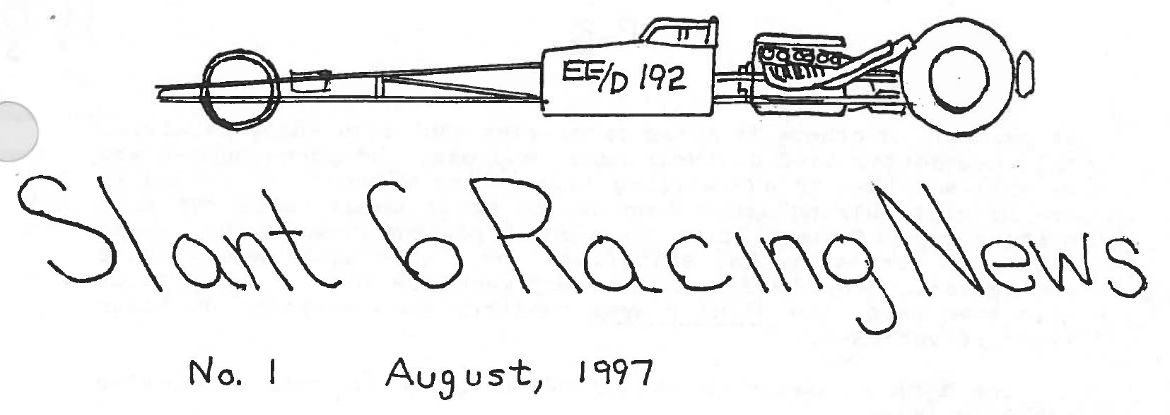

Where it all began:
Here is the very first SSRN article published in August 1997.
This was the cover drawing of that first SSRN:

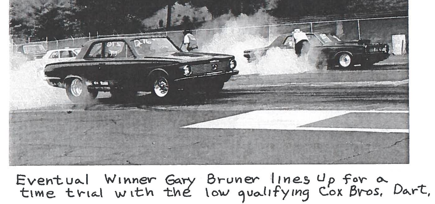

Here is the very first race report from that first SSRN #1 in August 1997:
GARY BRUNER SHOOTS OUT SIXES AT BRISTOL
Here is the photo to accompany that first race report.
I have the color originals back in KY. Hopefully someday I will get around to scanning those as well...
Both Desperado and the Cox Brothers 66 Dart were red. :wink:

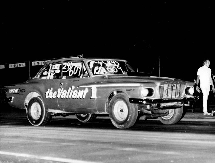

Not really slant six related, but creative stuff to watch and ponder.
Sherman Sligh, racer extraordinary.
https://www.youtube.com/watch?v=YE-NHC3K8ek
LS head on a ford six
https://www.youtube.com/watch?v=KK5Z1VNqasA
Cotton Perry, chevy six
https://www.youtube.com/watch?v=DQIMbCAiT7w
Bruce Sizemore in a ford pinto (Don Hardy Chassis)
Bruce at 1:15
https://www.youtube.com/watch?v=3MKccurdKDQ
Anyway, you get the idea!

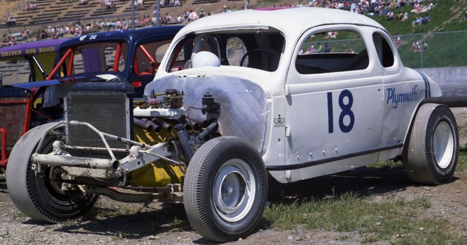

Check out this header science!
