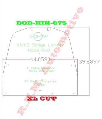

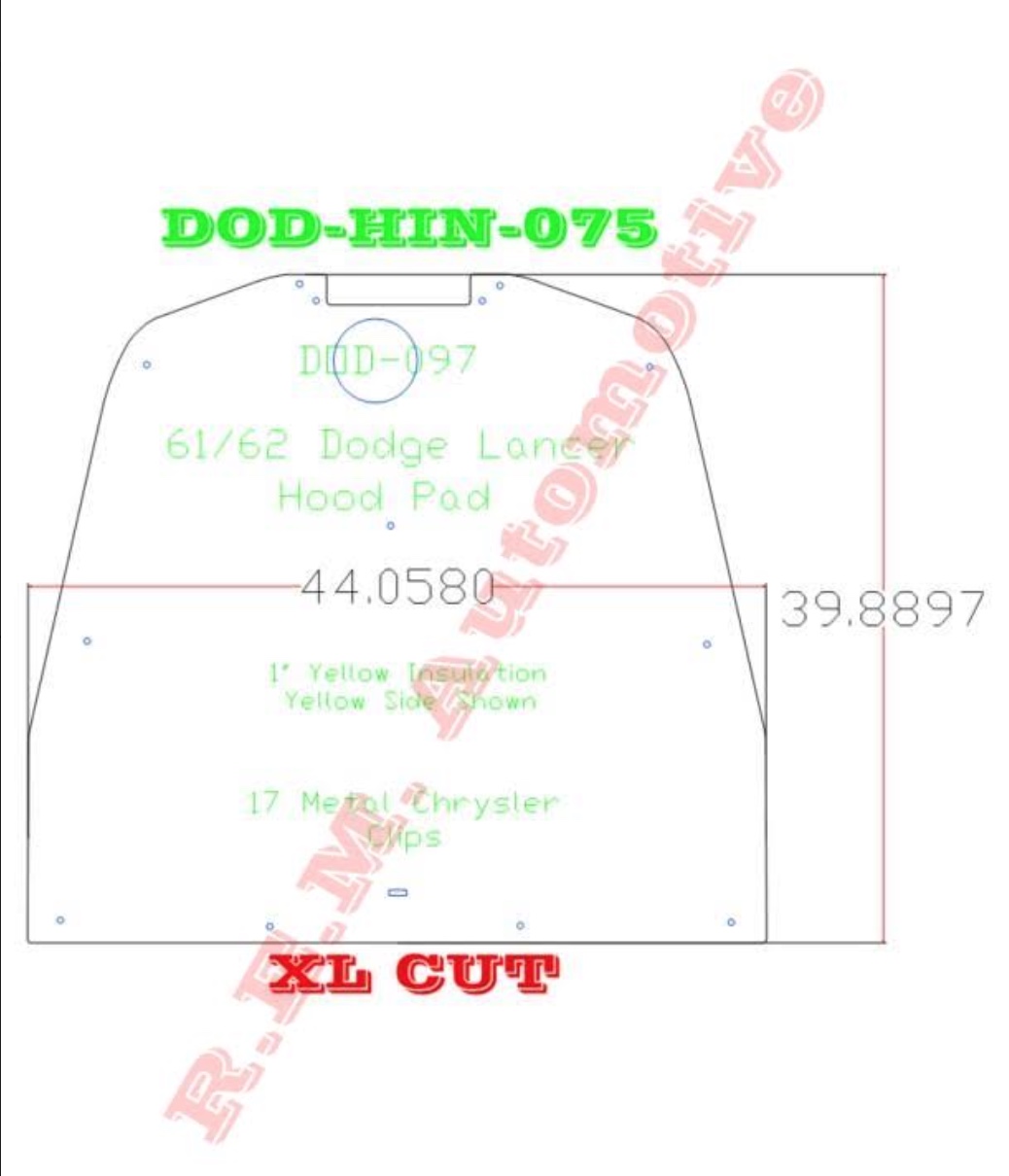

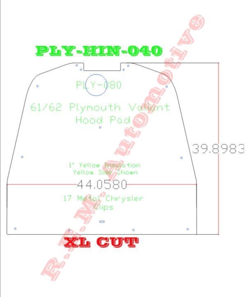

Repro pads are readily available in North America from REM Automotive, listed in the parts sources post. Part number is PLY-HIN-040 or DOD-HIN-075; same item under two different part numbers. No die cuts for the hood webbing. Shop around; different REM dealers have different prices on it.
AFAIK it's not available in Australia, and I know it's not available in Argentina (I sent two of the REM items down there last year, to the guy who would know if it were available locally to him).
