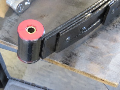

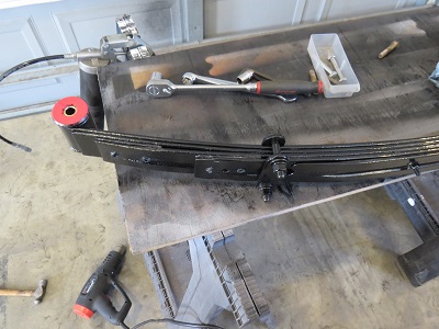

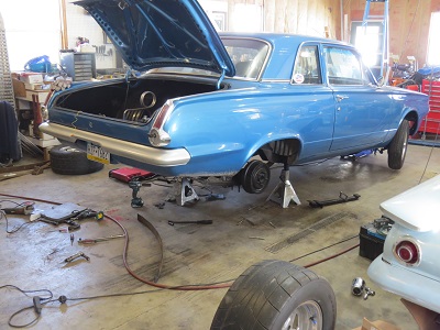

For the last few months the Valiant has been parked in the attached garage awaiting its turn to go to the detached garage where all of the real work takes place. Wife and I have been remodeling 3 rooms and now that that project is coming to a close I took my truck out of the garage and drove the Valiant up there. I still have Ryan's race car in the garage also so the truck gets to set out in the cold for a while! :D
I had planned to put the Weber carbs on the car before racing season started but I have changed my mind . I plan to do some other upgrades first and see what the car does. Then I can add the carbs later. I have to modify a set of headers and install a smaller master cylinder, so the Webers will be a little more than a bolt on deal.
Dennis told me the 4.56's would probably be to much gear for the car and with the short (26" Nitto's) it probably makes it even worse. So for now I am going to install my 3.91 spool and see if the car likes them. I also picked up a cone type sure grip ( worn out) from Howard Davis that I plan to rob the spider gears out of. I bought a 4.30 pumpkin from Ryan that has the spider gears torn up it. I will put the spiders from the Howard Davis posi over into the one I got from Ryan and then I will have 4.30's to try as well.
I have the car jacked up and I pulled the leaf springs off and installed all new Poly bushings in everything. Pulled them all apart and cleaned and painted them. I also added a 5th leaf that comes up to the front eye to strengthen the front half of the spring. While the cars jacked up, I'll swap the rear end and also install the green bearings that I have laying on the shelf. This way I can see what the suspension and gear change does before I change the carburetion. It will be nice to see back to back runs with the changes. Last but not least are the new tire. M/T ET street R's. They should do just fine and they allow me to run in the Street nite races if I want to since they are a DOT tire.https://www.summitracing.com/search/tir ... Street%20R
