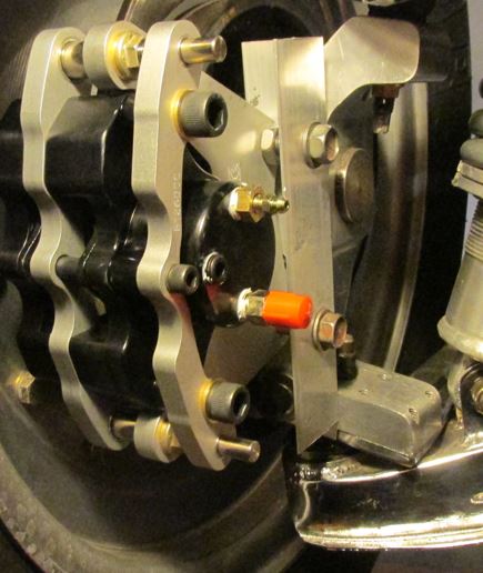

Maybe this shows the issue.
The lump of aluminum resting on the control arm needs to be removed.
However it mounts the steering arm.
So the steering arm needs to be relocated to the spindle before removing the lump.
And then shocks with a couple inches of more travel.
Or, I just go to struts and remove all the old original Hardy/Strange assembly.

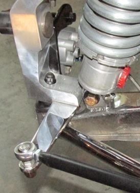

I can't see any steering arm in that picture. I am sure it gives you problems, but I can't see where the steering arm/ tie rod end etc. bolts to that AL spindle.
PostPosted: Sun Oct 13, 2024 4:34 pm
Posts: 9383
Looks like it is on the bottom of that square chunk going away from you in the picture, posssibly?

View from front side.

Could you taper the 'lump' for clearance?
If the steering arm was on top, yes.
Since it bolts to the bottom, and it is the point of interference, no.

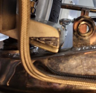

PostPosted: Sun Dec 22, 2024 5:01 pm
Posts: 2663
I did some thinking on my steering lift issues.
I made two videos to show the problems.
I think I am going to cut the aluminum spindle and that should add an inch or so.
https://www.youtube.com/watch?v=34Xm1UjrmPk&t=9s
https://www.youtube.com/watch?v=i4TO3kV0VZw
This is the planned cut.
