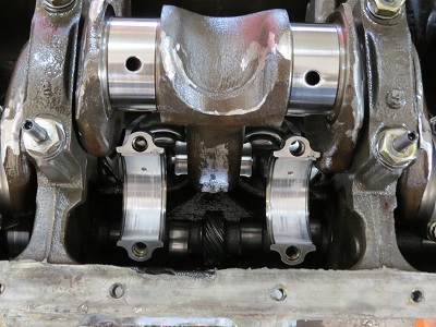

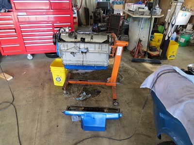

Go through tech and wait for them to cal Pro up and I head up to the staging lane. As I head up I noticed I forgot to flip my low oil pressure cut off switch on. When I did it killed the engine. A quick look at the gauge and it is reading zero!! Retried it just for a couple seconds and no pressure. So I arrive at 11:00, load up at 12:15, and head home. After checking the oil level, filter and switch (The obvious things) I realize the motor has to come out! Started at 2:15 and at @ 5:5:15 I had this.

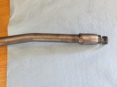

After I got the pan off I found the pick up had broke off in the block. I debated whether or not to install a brace on the pick up. Now I know the answer.

PostPosted: Mon Aug 06, 2018 7:37 am
I wonder if the heat from that weld near the threads weakened it...(?)
It's a bit more bulky and cumbersome, but adding standard pipe nipple and a joint to extend the tube may be a more sturdy method.
Or consider welding the extension further from the threads on the next one.
PostPosted: Mon Aug 06, 2018 8:31 am
heat from that weld
and see the posts at Greg O's low oil pressure thread about shimming the oil pick up, may be easier than fabricating a bracket.
PostPosted: Mon Aug 06, 2018 9:41 am
Posts: 9542
The bracket would likely be one of the easiest thing to do in my mind. I don't want my pick up tight on the floor. Any way I will likely go ahead and install the external pump on the motor if it is not damaged. If it is damaged then the back up motor will go in. RC
That pick up extension was made from a 2" pipe nipple.
PostPosted: Mon Aug 06, 2018 3:17 pm
Posts: 14986
IIRC, Mike cut the pickup further down and put the extension piece in to stay away from the cracking up top.

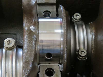

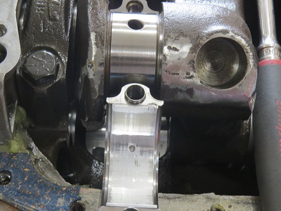

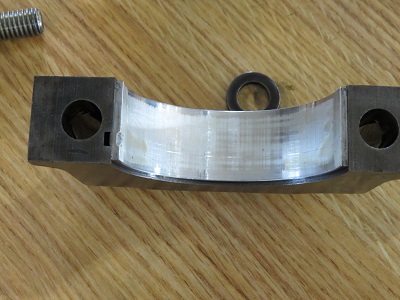

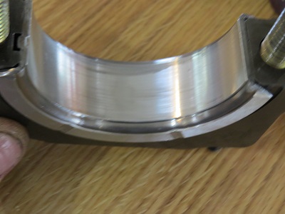

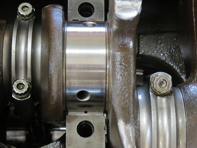

Here are some pictures. The crank looks perfect. I pulled the center 2 mains since they are the easiest to get to and they feed 2 rods each. I pulled the # 1, 3,4, 6 rods and will go ahead and pull the other 2 . All the bearings look exactly the same. I think they just show the normal wear of a 6000 RPM race motor with 70+ runs on it. None of the places on the bearings that look like lines are able to be felt with a fingernail. They all feel smooth. I am thinking the shinier spots are the high load areas and normal wear?? At least I hope so. I was hoping not to pull 1 and 4 mains if everything else looked fine but maybe I should? Opinions on the bearings?
