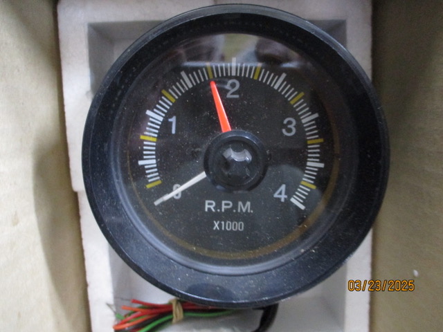

I am going through some parts for the Mo-Kan swap meet and I found this tach from Stepp's stuff. With your driving style, I thought you might want it.
It would be perfect for "The Colt".
Just let me know if you want me to hold it for you.

Jr, thank you for being so thoughtful and thinking about me.
I am afraid that tach has too big a range for my little lawnmower.

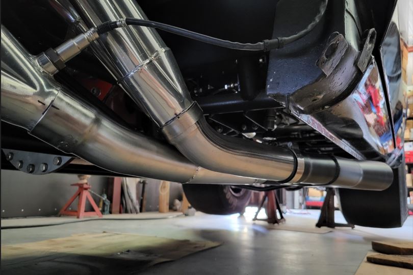

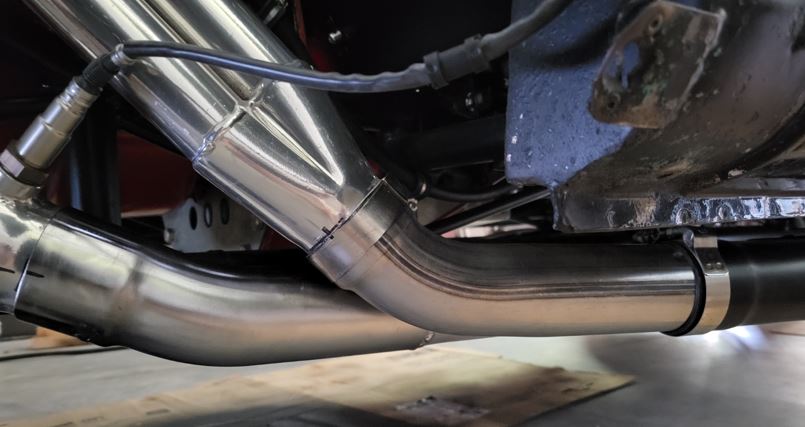

Last piece off the MOKAN puzzle.
Lets hope it adds a little torque down low.
It was a lot of work.

PostPosted: Sun Apr 13, 2025 6:40 pm
Posts: 9488
That looks good Stan!

So with a TIG machine, here is what I have learned.
You can not practice enough.
You need GOOD eyes.
You need a steady hand.
And never, NEVER, ever, ground your Tungsten electrode.
Other than that, it's still an art.

Wait until you try some Aluminuim :shock: :shock:

Made a new video before (cross your fingers) MOKAN.
New Flowmaster has a very different sound from the separate headers.

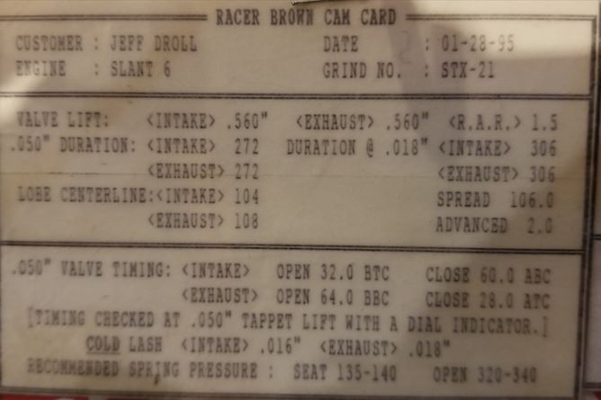

Two questions:
1) I thought you said you had the ST-21 cam, same as in Seymour's 62? That STX-21 is WAY bigger and needs more compression and RPM.
2) Do you mean 106 lobe separation angle, or 106 installed centerline? 106 is pretty retarded for a performance 225 cam. I would install at 99-101 or no more than 102.

Lou, STX-21, I bought it from Jeff Droll with his old head.
I like it a lot better than the ST-21.
I quoted what was on the card, please correct me for my ignorance.
