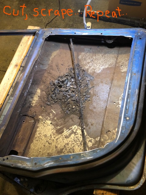

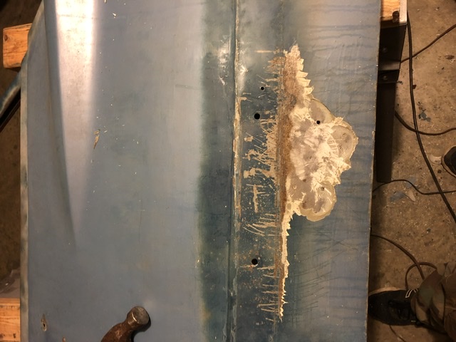

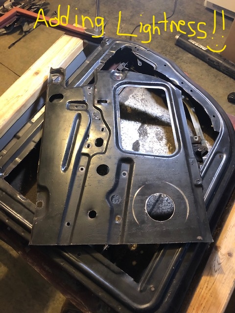

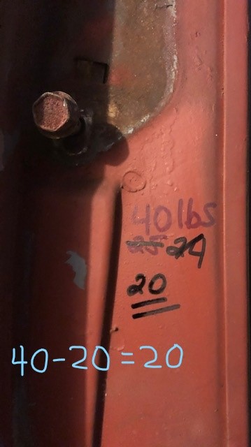

Rear doors went on a diet. :mrgreen:
I ain't the smartest guy on this team... I leave the thinkin' to folks like Adam, Joe & the Perfesser…
I'm better at the simple tasks...

PostPosted: Mon Dec 30, 2019 11:53 am
Posts: 17683
That's 75 lbs off the whole car. That is worth more than 0.1 sec in the 1/4 mile and probably a few tenths off lap times at most courses. Thanks, Rob!!!

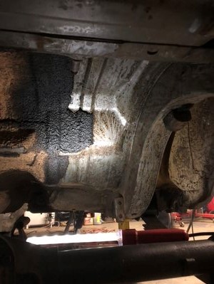

PostPosted: Tue Dec 31, 2019 8:42 am

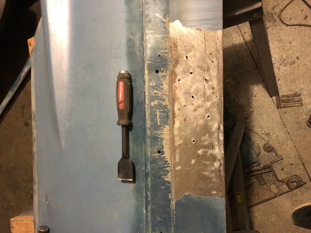

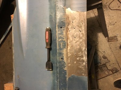

I scraped 5 pounds of undercoating and bondo out of the front passenger door.
That made me decide to go back and get the rest of the bondo off that rear passenger door.
My OCD gets the better of me sometimes...

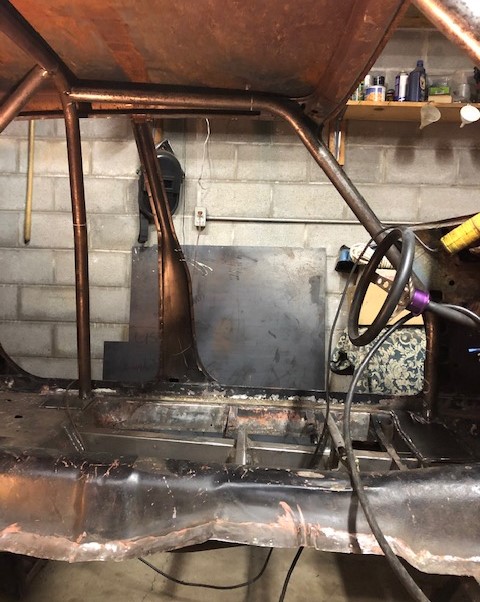

PostPosted: Mon Jan 06, 2020 8:43 am
Adam got quite a bit done on the roll cage this weekend.
I cut out some metal and scraped some undercoating...

PostPosted: Mon Jan 06, 2020 2:32 pm
Posts: 10443
Looking good.
Whose car is #46?
Weld that cage good and correctly. Lemons sourness checkers seem to be most picky about those bars..

Adam is taking the cage fabrication very seriously and the boy can weld. :wink:
He has been in regular contact with the main Lemons tech guy concerning the cage.
The tubing is 1.75" DOM rather than 1.50" ERW that we could get away with.
PostPosted: Tue Jan 07, 2020 11:32 am
Posts: 1170
Location: Houston, TX
Nice job with the main hoop location. Looks like it lands right on top of the rear subframe crossmember; I wish we'd done ours that way. Ours landed just forward of that, down in the "bathtub" we had to build for the driver's seat. At our first race, Jay made us gusset the main hoop to the rocker panel since he didn't trust our fabrication work.
