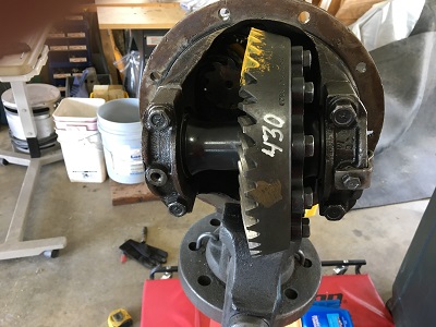

I didn't get to go run anywhere at the races this Friday or Sat. so I went ahead and disassemble the 4.30 rear that Ryan grenaded about 5 years ago. I inspected the gears really well and they looked fine. Axle gears and spiders, not so much!! :( :( So I had Dr.Diff send me a new spool and I installed that last night and this morning. With 4.56's and 26 " tall tires I feel like I am running out of steam at the big end of the strip. Everyone I know running that deep of a rear gear has 28-30" tall tires. So I'll probably swap them in tomorrow afternoon just for fun.

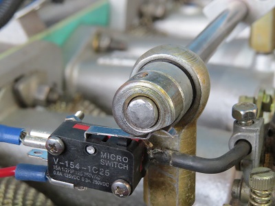

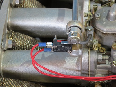

Ordered some micro switches and made a little bracket to hold it in place. There happens to be a boss with a set screw on the Weber carbs that has something to do with the choke I think. We are not using that for anythin since you really don't need a choke on the Webers. So it made a place to install the bracket I made. I took a 3/8" collar and ground one side of it down, and mounted it to the end of the throttle linkage shaft, so that when it rotates it deactivates the sense wire to my alternator. I tried it out and with the engine running at @ 4000 RPM I tripped the switch and watched my voltage. Voltage is about 13.9V when operating normally. I tripped the switch and watched my voltage drop. It took over 17 seconds for the voltage to drop below 13 volts. Since I run in the 13's that gives me a 4 second cushion of voltage over 13V to make a run on. I'll put a little paint and some wire loom around it later.
