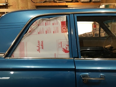

PostPosted: Fri Dec 27, 2019 6:52 am
Posts: 9338
3 lexan windows, removed door panels and winder = 25# gone :D :D
