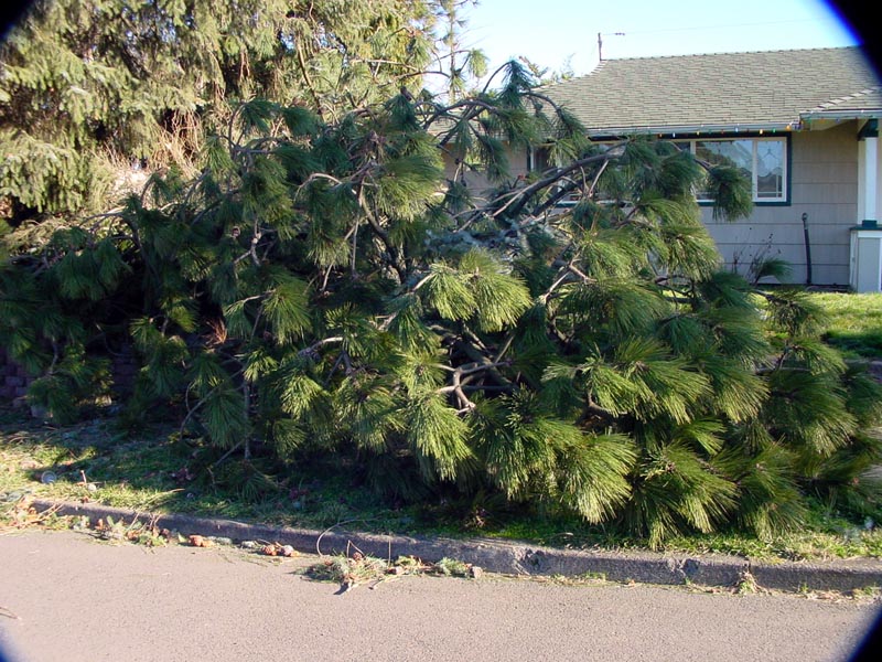

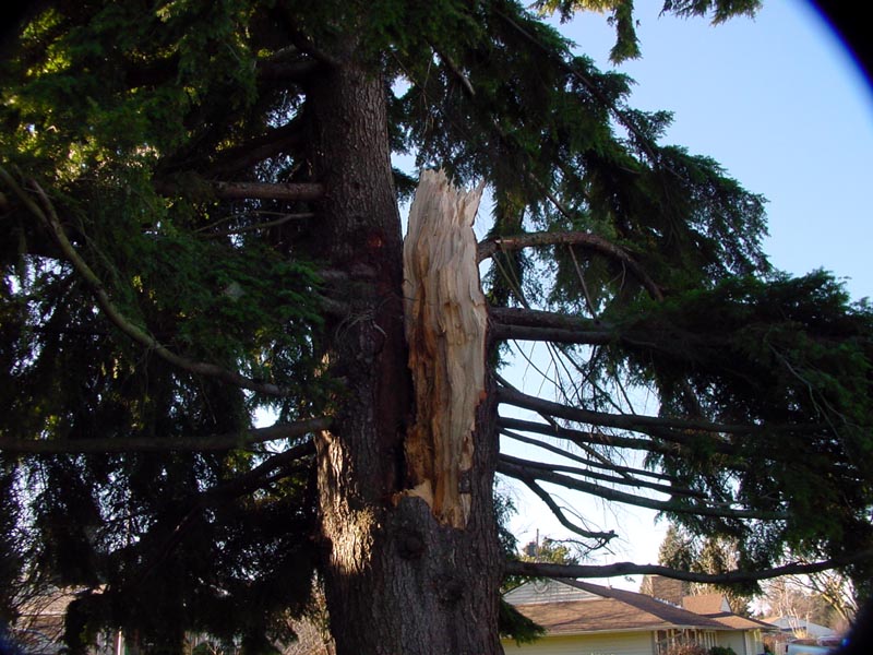

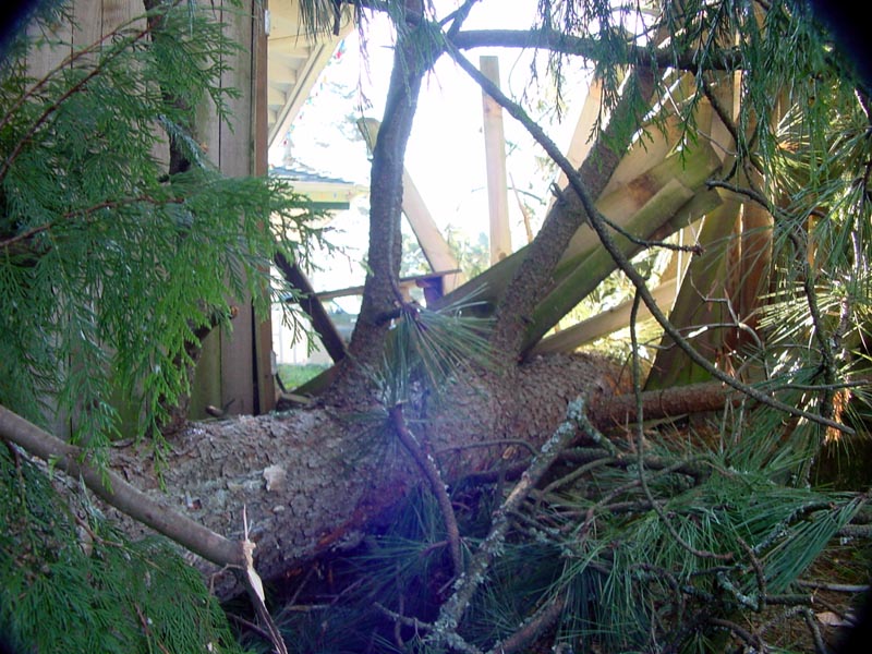

Many steps backward...besides being sick, a severe wind storm took out three huge trees at my home, one almost hitting my house, inches from crushing the Valiant, but the crunching of my large storage shed gave just enough resistance to save both...the same week, after moving my GTO into the driveway to get it clear of the trees and the wind still trying to blow them over. (3 weeks of continuous 40-60mph winds)A hit and run driver skidded 125' off the end of my street and smashed my GTO with a Dodge Durango. I only know this from the part numbers on the parts of his car left in my driveway when he drove off. I had just taken the insurance off it for the first time in 25 years because I had finished all the body work for a fresh paint job scheduled the following week, and I was going to put Haggerty insurance on it when it was finished...just trying to save a couple bucks to help pay for the paint...a poor decision to say the least. I could go on but I prefer not to think about the last three years.

Here is some of the damage from the trees coming down...

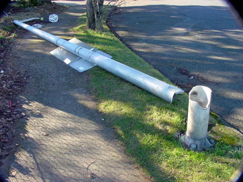

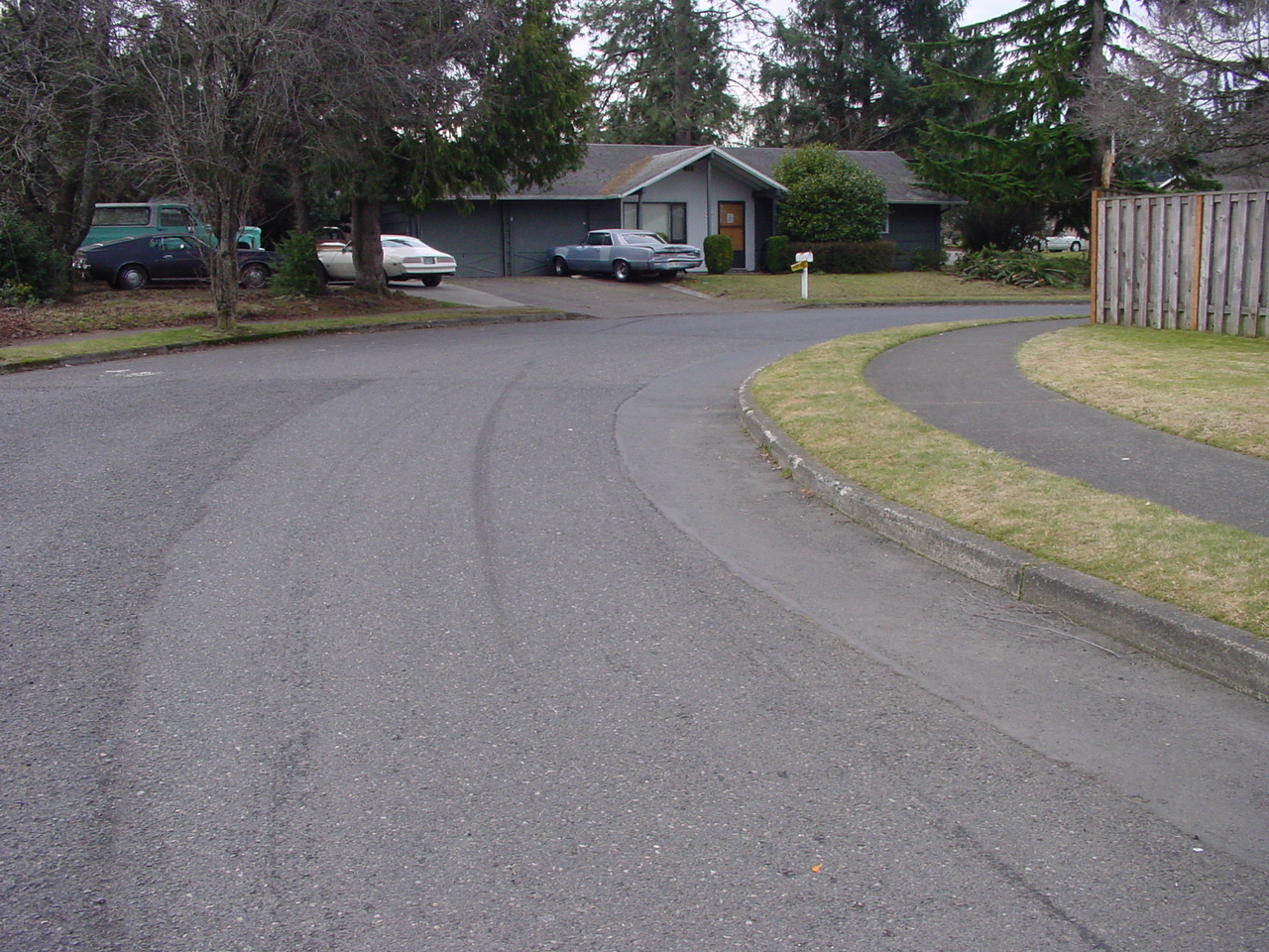

Also, the light post on my corner at the end of a 1/3 mile straight through a school zone, was pulled down by its wires when my tree came down. This darkened the corner so the idiot who blasted down the straight, couldn't see the corner until it was too late.
He skidded from where I am taking this picture, plowed into my GTO, then backed up and drove through two yards and a fence to get away.

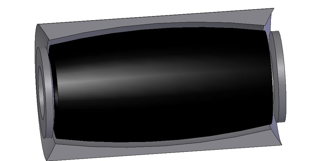

You are absolutely right Joshua about the upper bushings. I believe the tension created on the bushings when you set the alignment adjustments is why the urethane squeak so horribly.
I've been running urethane bushings in my GTO's for 30 years without issues, and the urethane bushings in the Valiants rear don't squeak. Trying every lubrication and penetrant I could find over the years, everything worked to quiet the squeaks...for two or three days.
So the more I thought about it, the more I believe it is built in tension in the bonded bushings, and I need a better solution. So I was looking at the Acetal bearings that are in our road race Firebird, which are a very simple design from Global West products, and I realized that, just as you said Joshua, as you adjust the UCA, there will be only one location where the bushings are on the same axis in a Mopar UCA.
So what could be done to handle this situation? Well, not having any suspension parts or parts car anymore, I can't measure and do up a Solidworks simulation of my idea to make sure it will work until I tear down the Valiant...but I can't think yet of any reason why it wouldn't.
My thought is simply use the existing steel shells with the rubber or urethane burned out or removed. Then create a five piece bearing assembly consisting of two outer shells(one machined shell, split in half two create two matching half sleeves) whose outside diameter would ride against the original, honed bushing shells. These outer shells would be machined concave on the inside diameter. A third piece, the central bearing as it were, would be a sleeve machined with a matching convex outer diameter and a thru hole for the mounting bolt. It would also have concave ends to match the last two pieces, the convex on one side thrust washers.
Again, these are just preliminary pictures and thoughts in my head and I haven't spent any time yet trying to prove out the concept, or whether it will work within the constraints of the available space. But its an idea...I have a few minutes, I will see if I can make a quick drawing of the concept this morning.

This was just a quick drawing I did just using dimensions off the top of my head to make a picture to describe the concept.
The thrust washers would be larger diameter, but essentially, as you adjust the UCA to dial in the alignment, all of the mating surfaces would adjust along with it, and retain a free moving bearing assembly within the original bushing shell.
I'm sure I will have to think this through more thoroughly, and then draw it up later with proper dimensions, and see how the assembly functions in simulation. Or someone here will find a flaw in my reasoning, and I'll have to think of something else.
