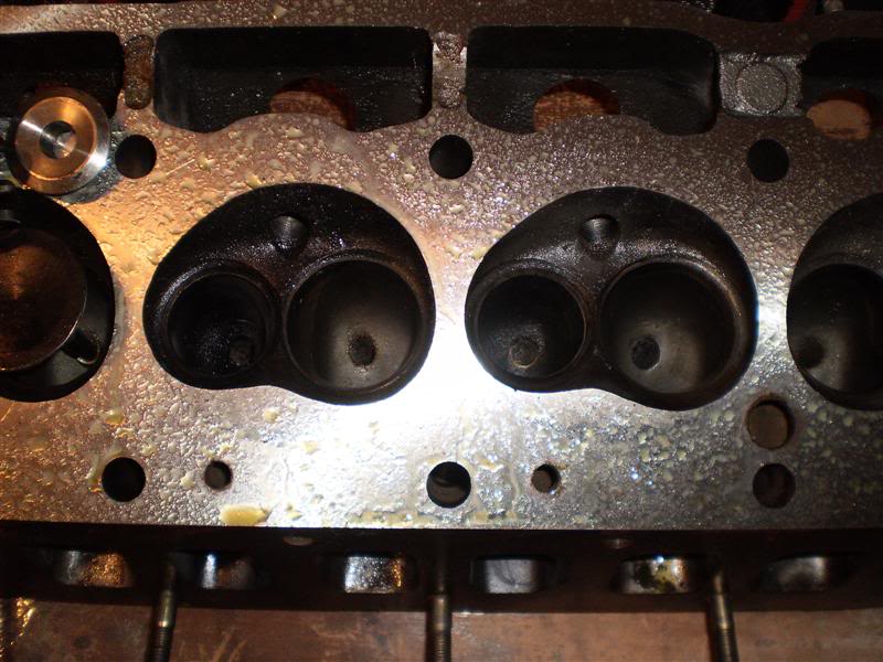

PostPosted: Thu Nov 14, 2019 5:03 pm
Posts: 2756
The chamber was like a 318 swirl port head.
 Post subject: Re: Al vs Fe
PostPosted: Thu Nov 14, 2019 7:05 pm
Posts: 14979
I have seen chambers done like that on a race head done here. Lots of welding, but supposedly made great gains in power.
PostPosted: Thu Nov 14, 2019 7:24 pm
Joined: Sat May 29, 2010 4:00 pm
Posts: 137
Location: Hastings MN
Car Model: Lancers
It is like the pic Stan posted. It is not going on a race engine at least not yet. It will hopefully be a powerful street engine to put in one of my Lancers. It has 14/1 compression ratio and will run on E-85. It is N/A and has a cam that hopefully will be streetable. The transmission has been beefed up but still maintains the pushbuttons and stock shifting. I will be putting on a Holly Sniper fuel injection to start with and see what happens. I have an Aussie Speed long ram multi-port fuel injection intake that I can put on if I don't like the Holly.
