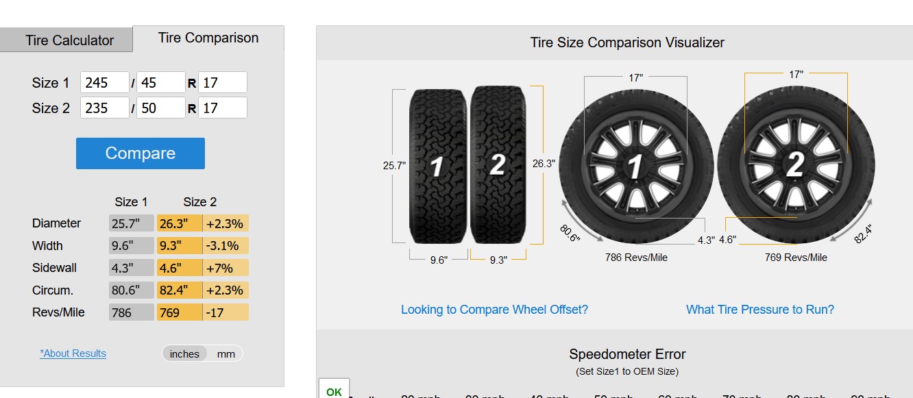

Do you know what rear gear ratios are typically run in the 350z / Infiniti G35 cars that had these trans's in them?
PostPosted: Mon Feb 08, 2021 10:40 am
3.54:1

Thanks Joshua, next up, what size skins are they rollin' on?
For those who don't want to flip back to the beginning;
1st - 3.784:1
2nd- 2.324:1
3rd- 1.624:1
4th- 1.271:1
5th- 1:1
6th- .794:1

Tire / wheel size is nice, but you really just need to know the Rear tire Diameter.

When l know the size of those "skins", then l will have that data Sir......
PostPosted: Tue Feb 09, 2021 7:59 am
235/50R17 (26.25") on a base 2005 Nissan 350Z.
PostPosted: Tue Feb 09, 2021 10:02 am
Posts: 10282
Cool that's pretty close to what I run now on most stuff.
