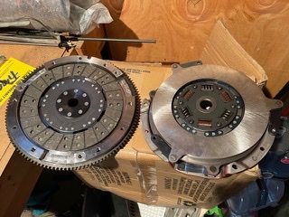

Here it is.

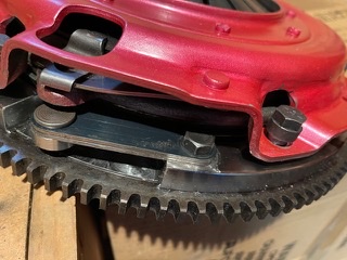

Another one…

Dang that's purdy. Thanks, Andy.

I just messaged their tech email with my request for the dual disc clutch package with alum flywheel and T5 disc spline. Joining the chorus...
Best,
PostPosted: Thu Sep 02, 2021 1:30 pm
Posts: 17462
OK, I just got off the phone with Mike and I have placed an order for 3 clutch/flywheel kits (for Ryan, Greg and me). All will have T5 input/disc spline and aluminum flywheel with big hub (68-up) crank opening. Mike was great on the phone and said production should happen in late Sept.
