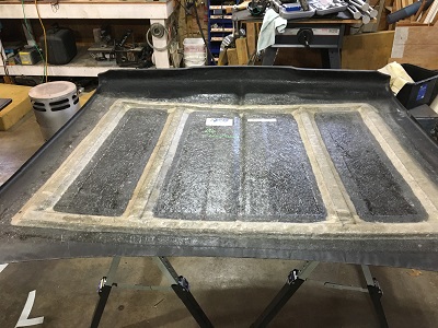

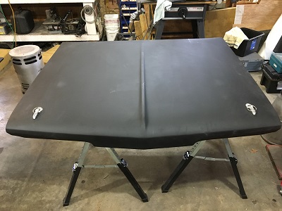

New hood and trunk lid arrived and the boxes were in good shape. I told the driver we would unpack them before signing for them and he was good with that (He sounded like a car guy too). Hood looked fine but the trunk lid that they sent was for a 64 Valiant. Not good! So Ryan called the VFN folks and they told him that 63-66 all used the same deck lid. No sir, I'm terribly sorry but you are wrong. :!: :!: So after holding for about 10 minutes for the production supervisor, they decided that they do not have a trunk lid for a 65. So we had to reject it and they hauled it back to the factory.
I got it home and looked at it a bit to see how I plan to fasten it. Probably will end up hinged at the back with no springs of course and a set of pins at the front.

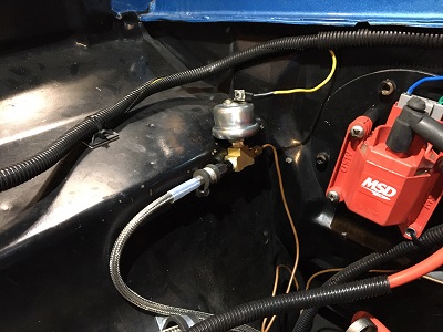

I also ran a new SS braided line from the block up to the fender to avoid any broken fittings on the block from vibration. Low oil pressure cut off (yellow wire) and oil pressure line go from the tee.

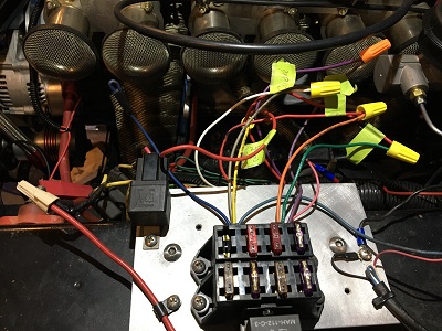

Removed the old wiring /fuse mess that I had under the hood and installed a new fuse block set up with a built in relay. All the wire nuts and tape will be gone shortly. Just wanted to make sure everything worked first.
