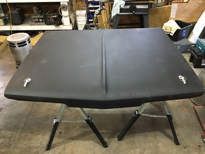

New hood and trunk lid arrived and the boxes were in good shape. I told the driver we would unpack them before signing for them and he was good with that (He sounded like a car guy too). Hood looked fine but the trunk lid that they sent was for a 64 Valiant. Not good! So Ryan called the VFN folks and they told him that 63-66 all used the same deck lid. No sir, I'm terribly sorry but you are wrong. :!: :!: So after holding for about 10 minutes for the production supervisor, they decided that they do not have a trunk lid for a 65. So we had to reject it and they hauled it back to the factory.
I got it home and looked at it a bit to see how I plan to fasten it. Probably will end up hinged at the back with no springs of course and a set of pins at the front.

Author:  drgonzo [ Sun Jan 26, 2020 2:06 pm ]
Post subject:  Re: Covalt - "Project 65 Valiant"
I always admire your work. That hood rocks!
