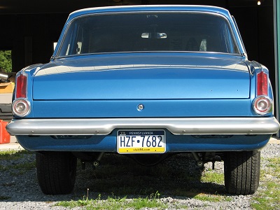

Just asking, but what is the difference between a '64 and a '65 deck lid? :?
PostPosted: Mon Jan 27, 2020 3:16 am
Posts: 9335
General shape is the same, but as the 64 gets back close to the back it gently rounds down. The 65 comes to the back and makes a sharper turn down and almost has a 8" flat area where it turns down. The trunk opening is cut to match so they won't interchange.

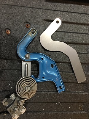

I removed the hood hinge and the spring and brackets that I made up when I redid the car. They weigh almost 5 pounds each. They will be replaced by these aluminum brackets.

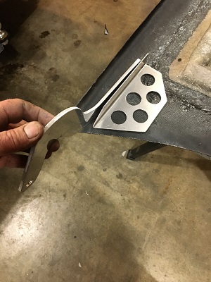

Then these "holey" aluminum plates will get Epoxied and then fiberglassed to the underside of the hood and that will be my rear pivot. Front will get captured hood pins so I can't loose them!!

Posts: 9106
Very cool! Where did you get those aluminum parts?
PostPosted: Thu Feb 06, 2020 6:05 pm
Posts: 9335
My Dewalt jigsaw! :D :D
I have a little aluminum supplier / welding shop that I get all my materials from. Usually I can pick up "drops" off the floor for scrap prices and use them for all my little projects.
