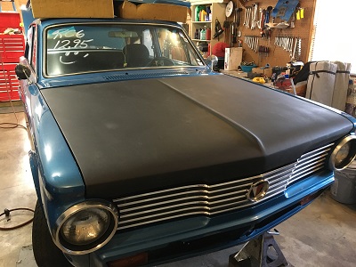

I did a trial fit of the new hood to see how the "fit" was and it was very nice.
After I get the brackets epoxied and glassed in place I'll get the hood pins set and then the final sanding, straightening and painting.

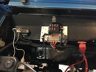

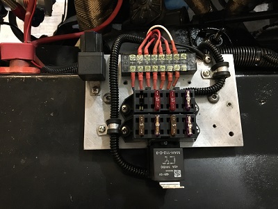

Also finished up installing a new fuse center out under the hood. It looks a little better than my homemade one.

That is very nice looking, Rick! You do good work.
