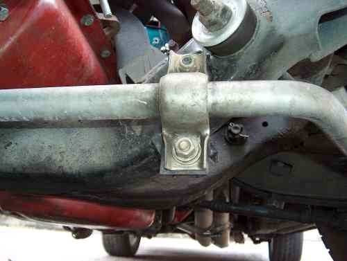

The challenge with the aftermarket front anti-swaybar kits is to mount the bar in a way that maintains good ground clearance.
The lower tab of the "saddle brackets", used to mount the bar, can hang low and hit speed bumps and such.
You can move the brackets outward and up but then you have to off-set the angle of the K-frame "legs" with a special "platform bracket".
Another option is to mount the brackets to the flat face of the K-frame but be sure to bend the lower tab 90 degrees rearward, then bolt it to the bottom of the K-frame.

Hey Doug, where'd you get that pic??
That image popped-up when I did a Google image search for sway bar mounts. I somehow knew someone would see it and say "Hey... that's my car" :shock: :roll: There are a few nice shots of swaybar install posted at that site.
