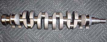

Inline cranks are actually neutrally balanced, but have counter weights to confine the stresses. From a crank flex point of view you want the counter weights equal in size and on either side of each rod journal like this:
The counter weighted crank still doesn't help the poor connecting rods though which was the thrust of my argument.
Getting back on target... To raise the RPM limit of an engine's rotating assembly without resorting to destroking one has to loose reciprocating weight or use stronger parts.
