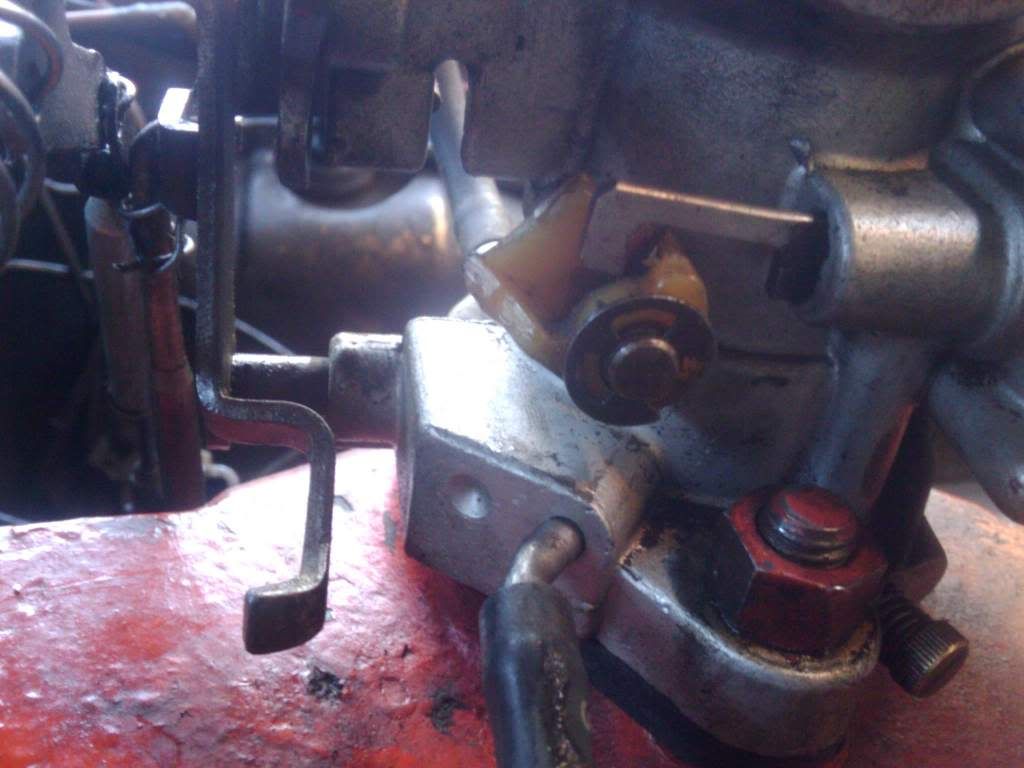

i believe what kevin is talking about is the copper piece on the inside of the coil wire that hooks onto the coil. also since most of your other parts seem to be okay according to you, and you were able to drive it but once you got onto the throttle a little and it died, it sounds like me and reed could be right about having a bad accelerator pump and or needing a carb rebuild.
Image how about this its been running like this for 3mths

Hold the phone up to it, so i can see it...
If you look down the carb, and activate the accelerator pump, does it squirt fuel? Fresh or reasonably fresh, viable fuel. What is the position of the choke flap?
When you pull a plug wire, and create a reasonable gap, and crank the motor, do you have a consistent spark?
Next, I'd use a timing light to rule out a slipped timing chain, and inspect the distributor for a loose bolt.
Then I'd want to look at the spark plugs if not any firing or back firing.
NO FUEL IS SQUIRTING!

if no fuel is squirting. pull the fuel line off the carb. grab a small cup or something(so gas doesnt go everywhere), have someone crank the motor for you and see if it squirts fuel. if it doesnt then your fuel pump is most likely bad. if it does then id say your line is either clogged, the float needs to be adjusted, or the accelerator pump just isnt working.
