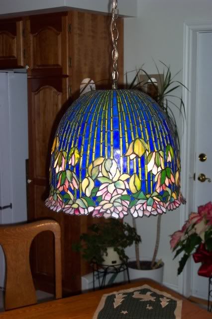

Not related to automotive soldering info department:
I construct Tiffany reproduction stained glass lamp shades using his copper foil method as opposed to lead came. On these projects, liquid acid flux is used to clean and etch the copper for soldering. When building a shade, the project is first tacked, and rough soldered together with 50/50 solder, and than a decretive solder bead is built up over the 50/50 using 60/40 solder which melts as a lower temperature than the 50/50. This tacking & beading can take many hours on a large lamp requiring an adjustable heat iron to prevent over heating the 50/50 base. When completed, the lamp shade must be completely scrubbed inside & out with a flux neutralizer to prevent destroying joints, and producing festering unsightly white stuff (I suspect is some kind of lead oxide).
I have about 15 hours of soldering out of 90 construction hours into this 1650 piece lamp hung over our kitchen table. Each piece of glass is cut from a sheet of art glass (automotive tie-in: I use automatic transmission fluid to lubricate the cutting wheel), their edges are than ground square using a wet diamond glass grinder, copper foiled (a little over a 100 yards in this project), than placed & secured on a three dimensional pattern to be soldered into five repeating sections which are than joined to form the shade. This shade utilizes about ten one pound rolls of solder.
Flowering Lotus: 18" dia. by 14" tall, requiring 11 square feet of glass.

Wjajr, that stained glass work is beutiful! I'll bet that could go for a good hunk of money. Oh but the time that must have taken to assemble.
......Just great work!! ..........

theomahamoparguy:
Thanks.
That lamp shade took about 90 hours start to finish including wiring.
