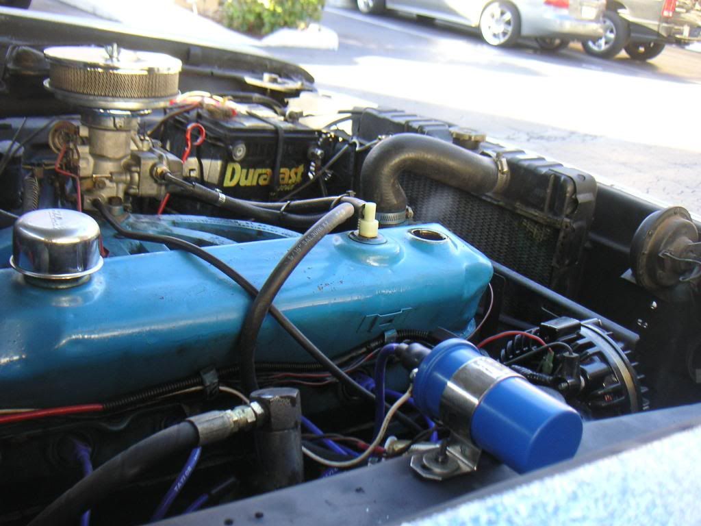

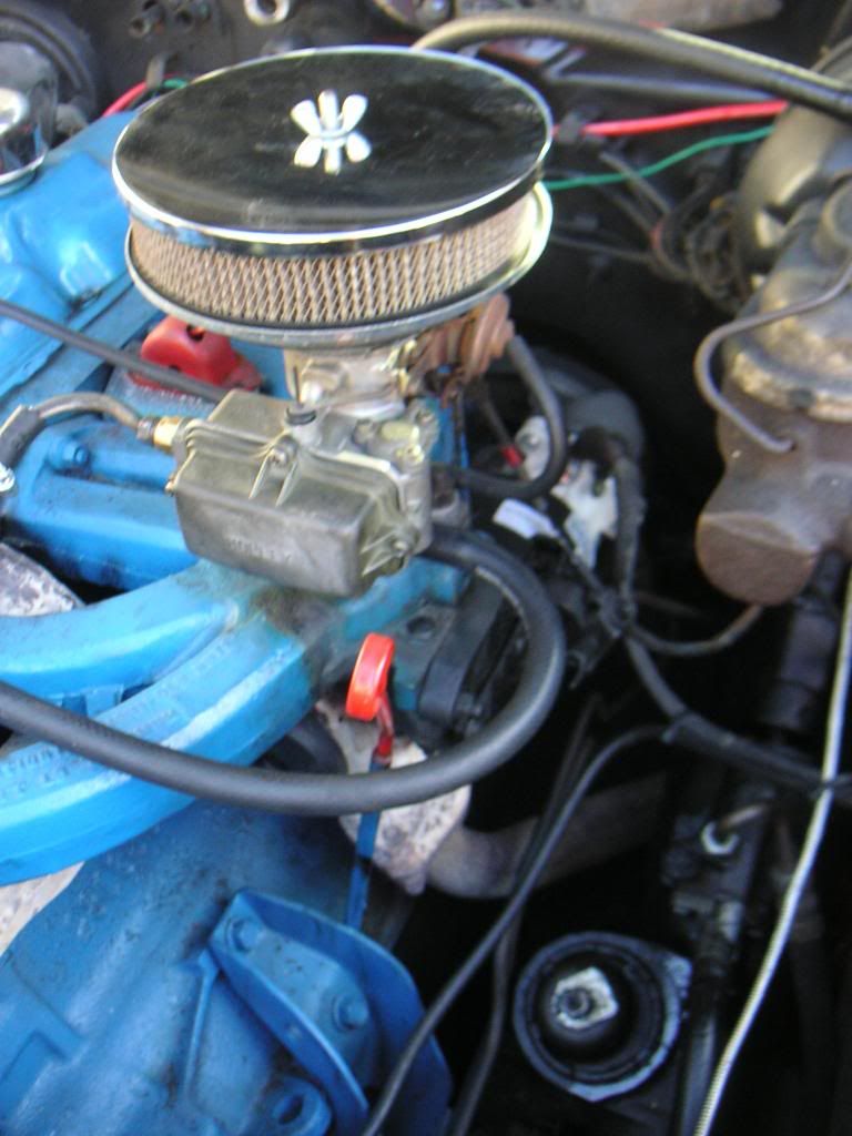

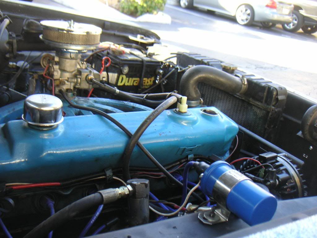

the car :
engine bay :

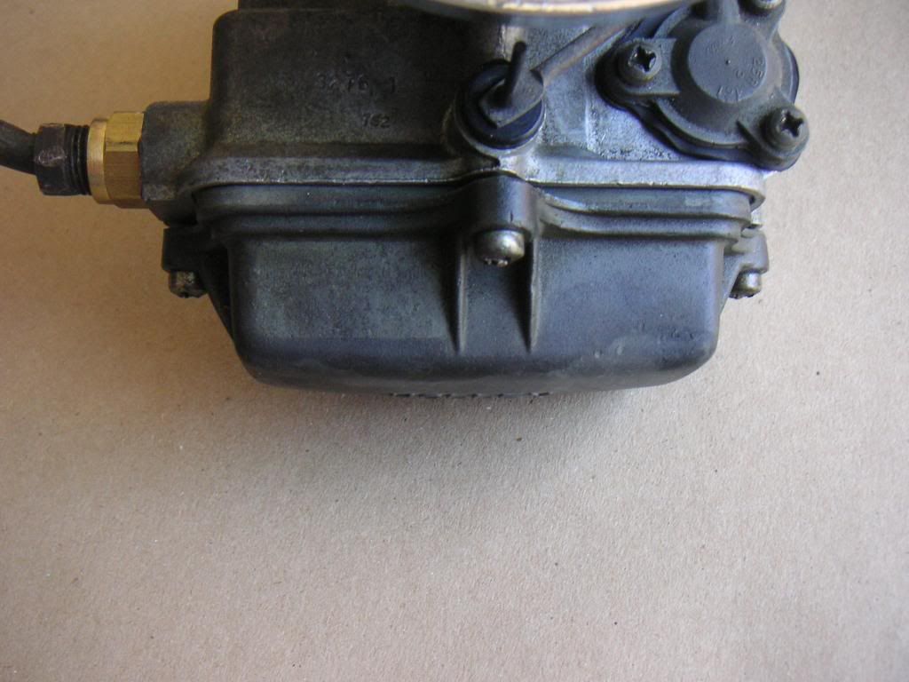

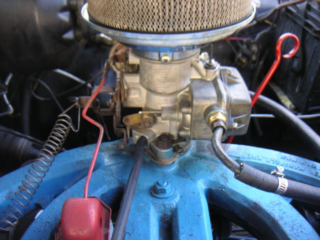

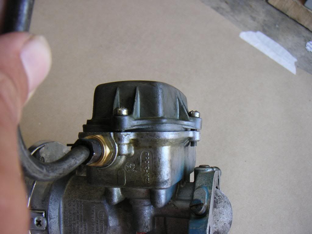

carb:
float bowl cover pictured to show how torqued out the 4 mounts are on it. and yes no matter what it does seep a bit of gas.

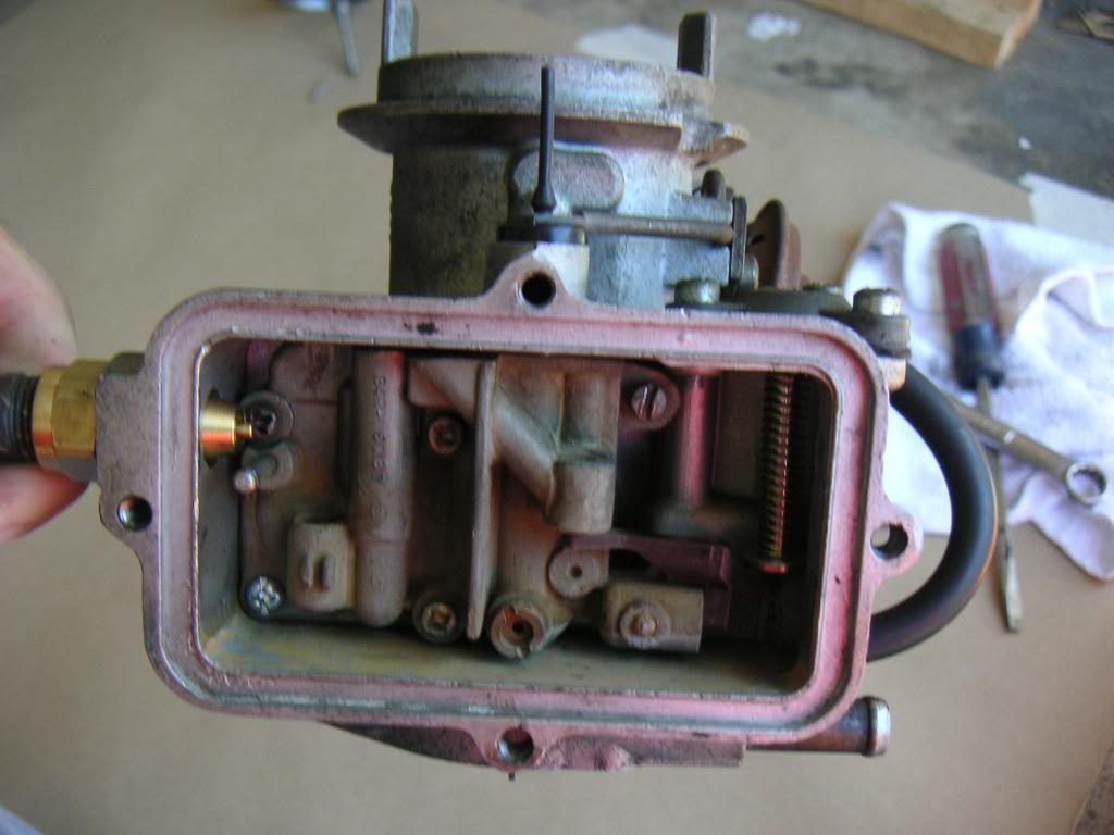

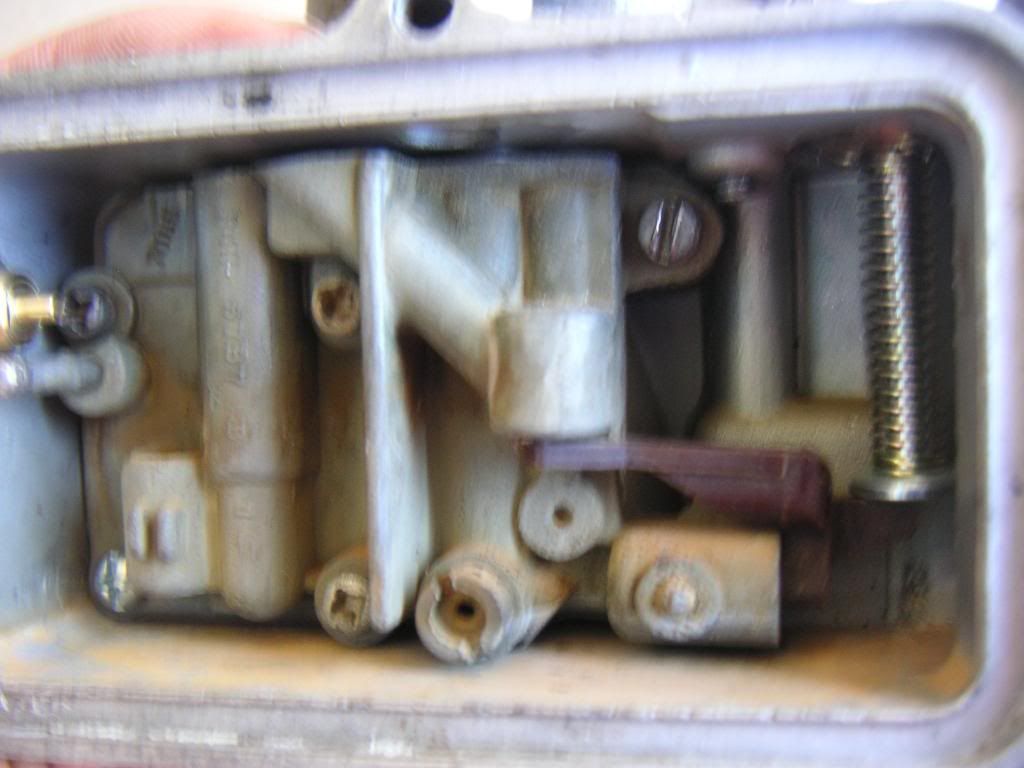

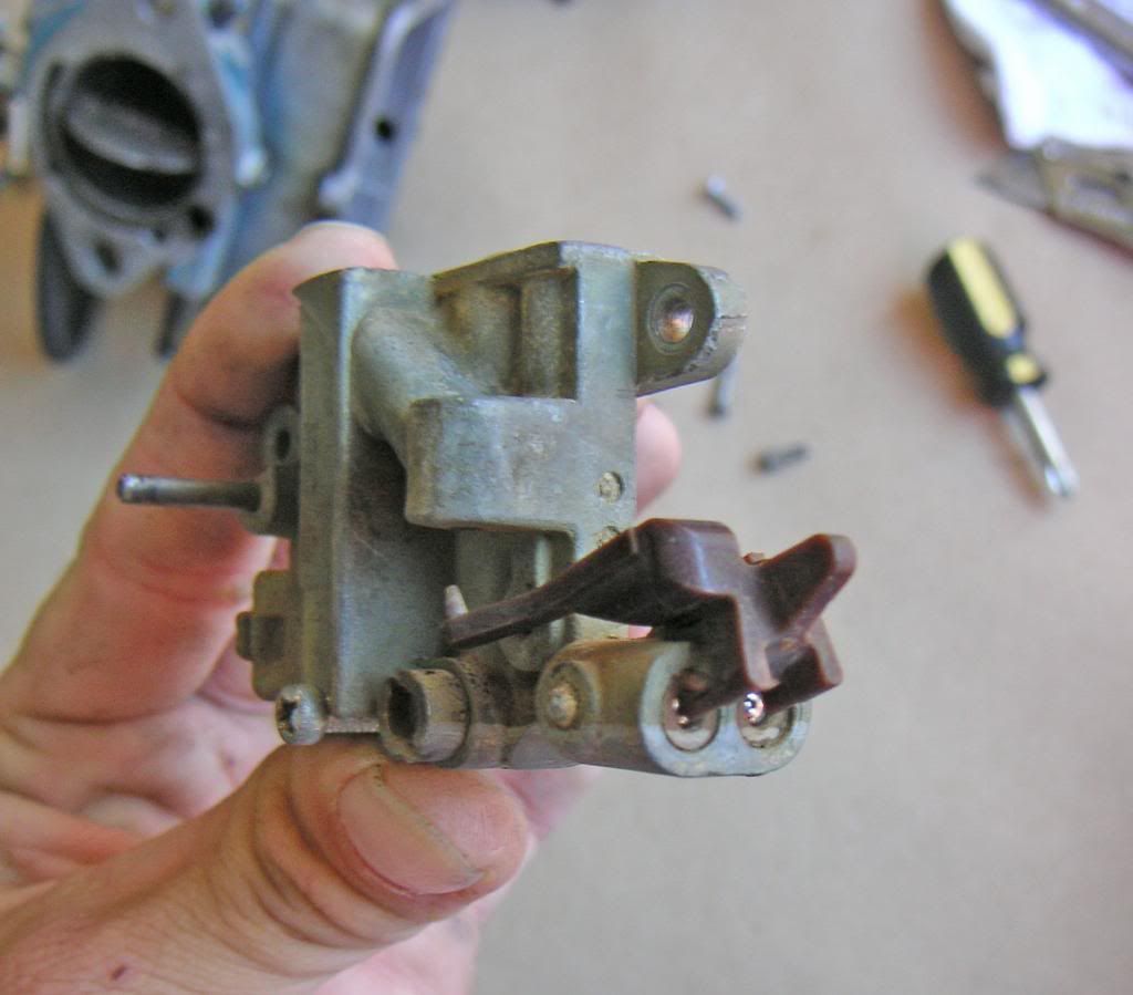

guts. - special note - also missing the inner baffle :(
somehow magicly now the third part manages to line up with its respective hole... maby I managed to bugger it back to its origonal position or it has worn its self a new groove to hinge on.
the plastic ears that hold the part to the main boddy are a bit worn and allow some wiggle room in it... so this part needs to be replaced im shure. and quite seriously - im amazed and baffled now as to why this piece lines up to press in all 3 of the loaded bearings in the block now. last time I had the carb apart - maby a month ago - no matter what I tried to do I could not get the little plastic arm to line up to get all 3 spots like its doing now.

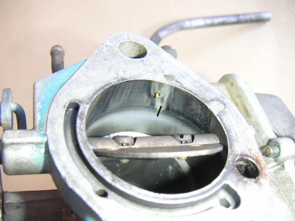

after taking apart my carb - I cleaned it with parts cleaner - and re assembled it carefully.
this is a shot before cleanign showing my low speed settings and ugly residue on the carb bore.

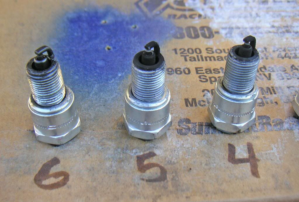

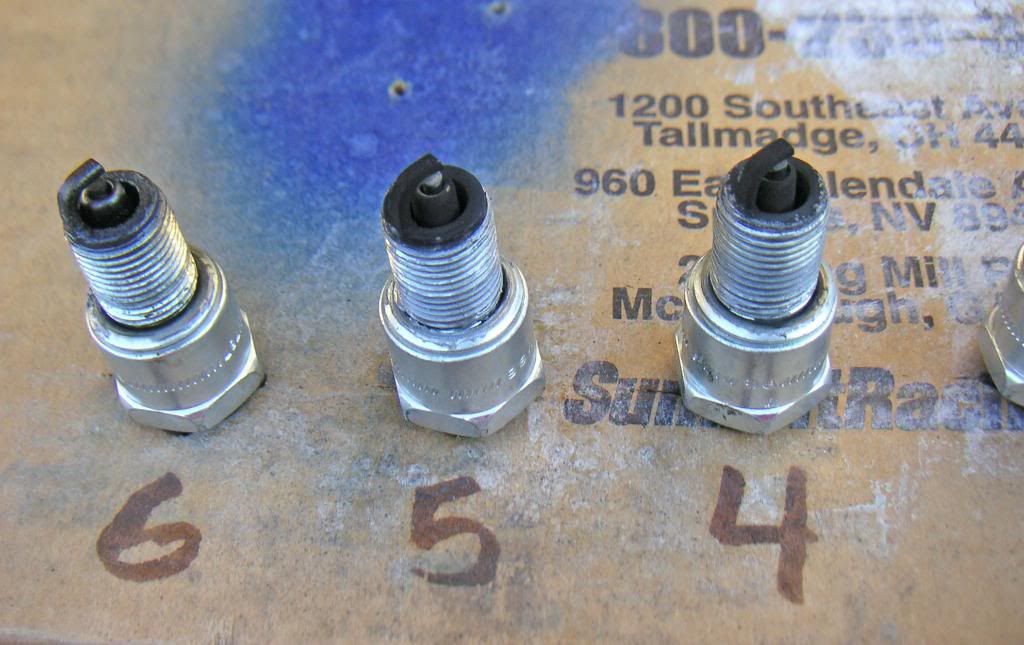

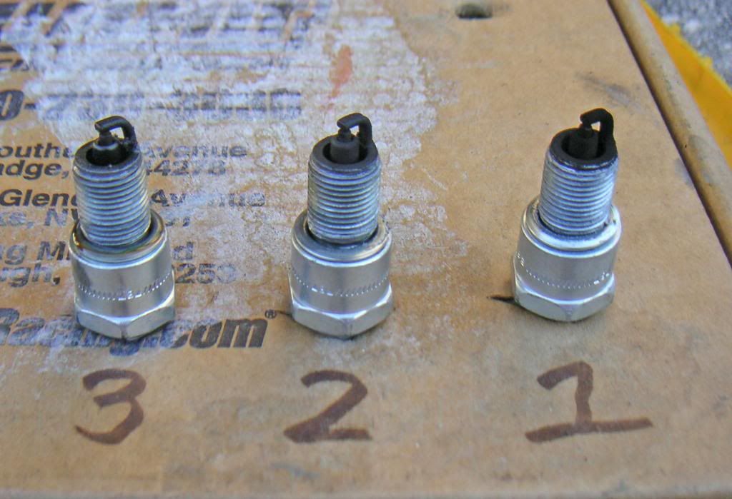

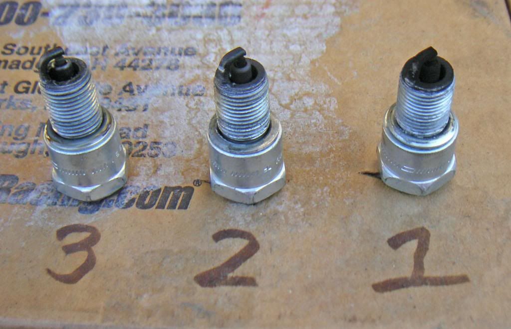

so I also decided to pull out my plugs to see how they looked.
I had a spare set that I cleaned and gaped to .035 and then as per slant 6 dans directions I took off the crush washers on them. - as I had not done this yet.
this photo shows the plugs I pulled out. plugs are #1 front of engine back...
and I was basicly horrified to see my plugs this nasty.
note the crush washers are still on - and the rear most plug has some oil residue on it. the rest are just black soot covered - and covered completely.
so the plug set with out the washers were in. I put the carb back on - and gave all my engine fastners a little tightning. I noticed my carb bolts were not verry tight to the intake when removing - but the gasket showed no signs of leaking.
what the heck - ill fire it up.
starts up nicely after gas fills the float bowl.
drove it around the block a fiew times - after it warmed up - it ran verry nicely. no more hickups or sputters or part throttle coughs. its verry responsive to sudden gas pedal stabs - and runs about as good as it ever did when ive owned it ( a little bit over a year now i think )

Glad you got it put back together and it's working. When you call Joe's ask for the three plunger plastic arm. It's for the enrichment circuit that the power valve actuates.
In the future when you have the economizer body out I thoroughly flush each ball out with carb cleaner so they seal.

I would do a compression test on each cylinder. If they are low (below 100#'s) you might try running a little Rislone to free up the rings. If you try a quart of Rislone it may take a few thousand miles before it cleans the carbon out so they can seal again. Stuck rings and cracked or missing valve guide seals will contribute to oil fouling the plugs.
