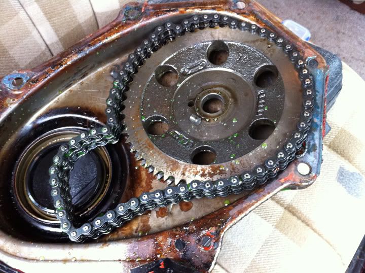

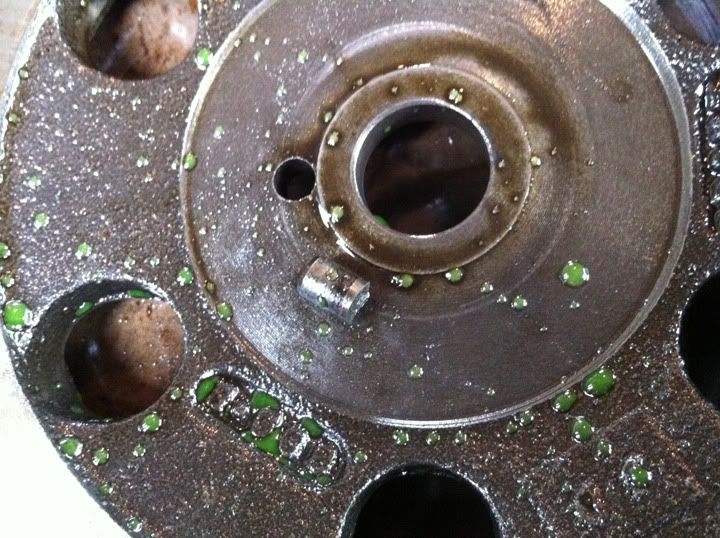

Well, the verdict is in. My brother got the timing chain cover off today and discovered that the cam gear hold-down bolt had, in fact come loose. This is odd because I know I torqued it down correctly the last time I was in there about a year ago. The bad news is that it appears the cam gear wobbled on the bolt and snapped the locator peg on the cam off, so the cam is toast.

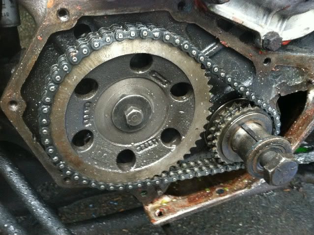

The good news is that the MP timing set appears to be holding up just fine after ten years of service.

Reed why not try to put a new pin in the cam. You could drill a hole in the broken pin and tap the hole for a small bolt, using the bolt and a nut larger than the thread (feature a small gear puller) :?:

For Ted, here is a picture of the Mopar Performance double roller timing set. It has held up well and is still in good shape.

Oh, yeah, Delta Camshaft in Tacoma says that they can repair the busted locating dowel for $18. Sounds like a deal to me.
