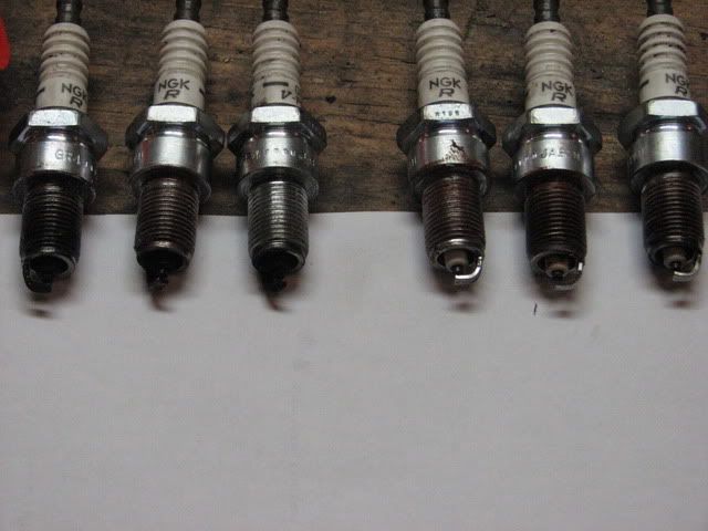

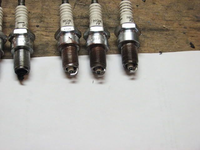

One thing I noticed that is odd was when I removed the NGK plugs to install the new Autolites, I noticed the insulator on cylinders 1,2,3 was black. That didn't really surprise me on a new start up. But #4,5,6 were still nice and white. So after I tried to start the engine with the new plugs I pulled them all and they were the same way. 1,2,3 black & 4,5,6 white/clean. I have no idea what that means. if anything.
I probably have something wrong somewhere, but I don't know what!!
Rick
1,2,3 on left
This shows a little better the difference. 4,5,6 on the right
PostPosted: Thu Feb 02, 2012 5:43 pm
Posts: 3864
sounds like timing to me, check cam timing, spark plug wire routing...
change out the distributor, ( like the idea of a points unit)
and post again, no matter how it goes!
I once struggled with a Buick v6 for a week, then found I had two spark plug wires crossed..
