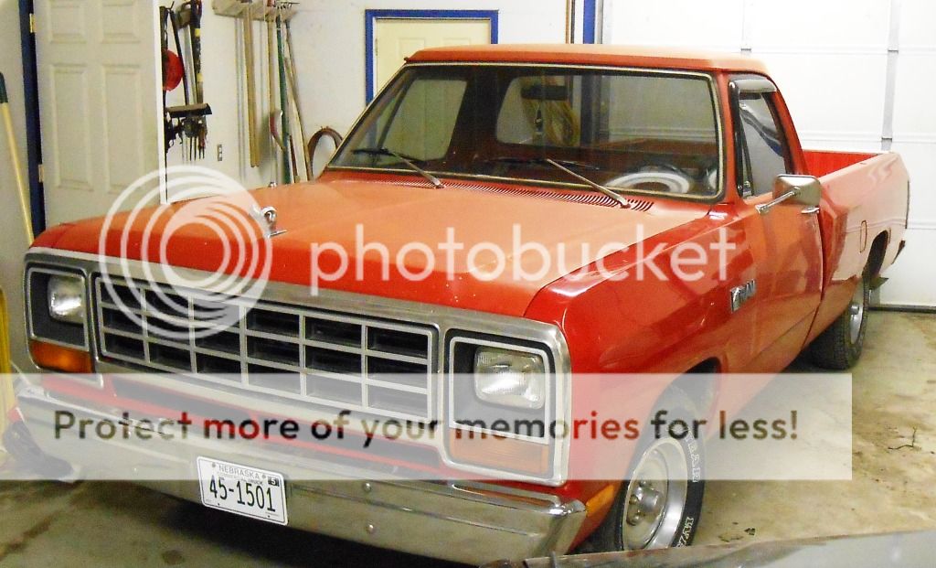

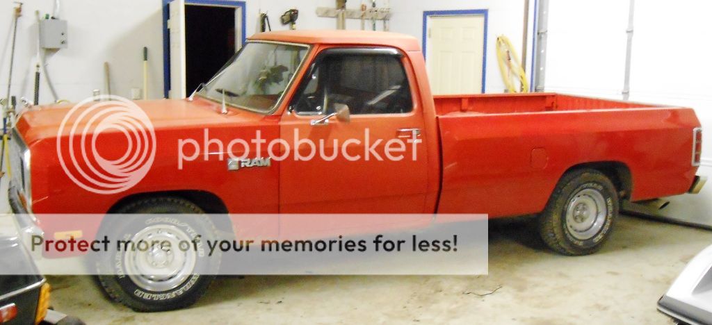

Next weekend I'm going to show him how to run a buffer! This should be entertaining.
PostPosted: Thu Apr 18, 2013 11:32 am
Posts: 13281
Nice! I like the road wheels. That looks like it will buff up pretty good.
